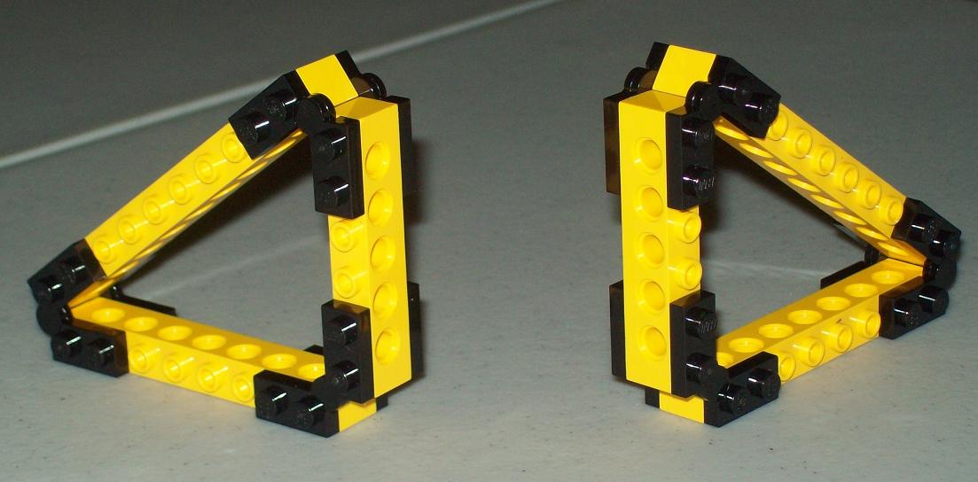

Tomik Posted March 10, 2015 Posted March 10, 2015 (edited) I dealt with triangles too when I was building my propeller plane. I made simple excel table where I found these triangles with right angle that are useful for Technic beams. Lenghts are measured between centres of hole so if you want lenghts in holes (number of holes in beam) add 1 to each number. Triples with * are not 100% correct but still works with Technic beams. 3 / 4 / 5 5 / 12 / 13 6 / 8 / 10 6 / 17 / 18* 6 / 18 / 19* 7 / 11 / 13* 8 / 9 / 12* 8 / 15 / 17 9 / 12 / 15 10 / 15 / 18* 11 / 13 / 17* 12 / 12 / 17* Edited March 10, 2015 by Tomik Quote

Boxerlego Posted March 11, 2015 Posted March 11, 2015 (edited) Link to the thread I got some of the pictures from. Edited March 11, 2015 by Boxerlego Quote
