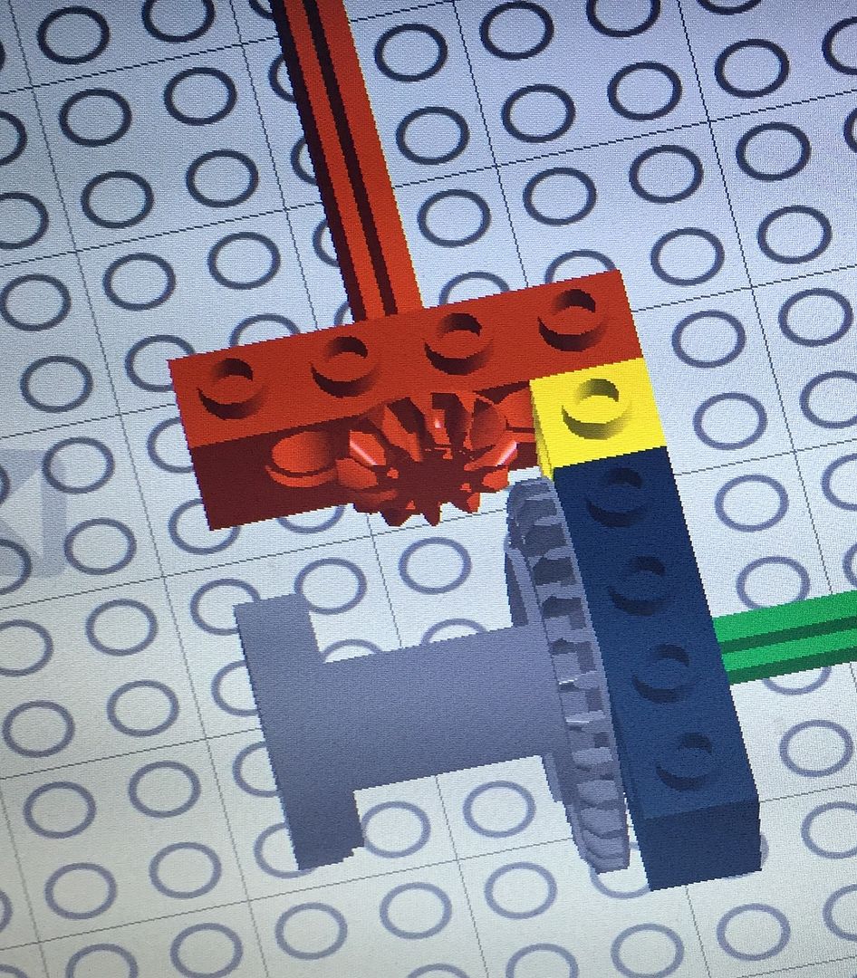

Will a 73071 accept drive at 90 degree to the outer 28 teeth from an 12 tooth 6589 as per the drawing herein if the YELLOW brick was removed and the entire RED assembly was moved one stud closer to the BLACK brick taking the YELLOWs place?
I know the differential i've used in the picture is not the same as a 73071 as per my technic model 8850 but i'm not having much luck explaining the question otherwise.
If i had access to a 12 tooth i could test all this myself but i've never even seen one.
Thankyou in hope in advance, glen.

I've just thrown something together, and it works fine.
You may find that integrating components that were designed for the studless system into a studful construction somewhat more of a hassle than you first expect - you often need half-stud offsets to get things to line up. Good luck!

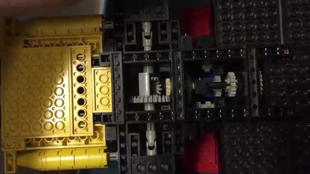

Have obtained an 12 tooth bevel. Gear does not transmit torque in the application and skips horrendously. It actually makes the 14 seem good by comparison. Video below is in the highest of the three gears and it can't cope even with the low loads that that places on it.
Shall stick with my modded sixteen. Has the added advantage of not just curing the skip but with my other bracing, its higher gearing (motor-differential) continues to allow first to be used.
Not that the 12 was a large investment, but would have been nicer to know it was not suitable beforehand. May add it to a centre diff in 14-12-14 config as like AllanP stated, the gears when mixed form an LSD, (even if the configuration is reversed) but its otherwise superfluous in the interim.
You're right. It sounds really bad. The old differential and the relatively new 12-tooth gears are 'generations apart'. Thus, I am not sure the teeth profile (and axis spacing) were meant for them to mesh properly. The image below 'states' that the teeth/dimensions of old differential were designed for it to mesh with the old 14-tooth gear (same as those inside the differential). I am not sure offsetting the differential (left-right) is even possible.

Oh, sorry, that was partly my fault. When I said that "it works fine", I was reproducing the picture you had posted. Reading your post again I see that you meant using the old diff with the new gear.
Once again, sorry.
Owen.
