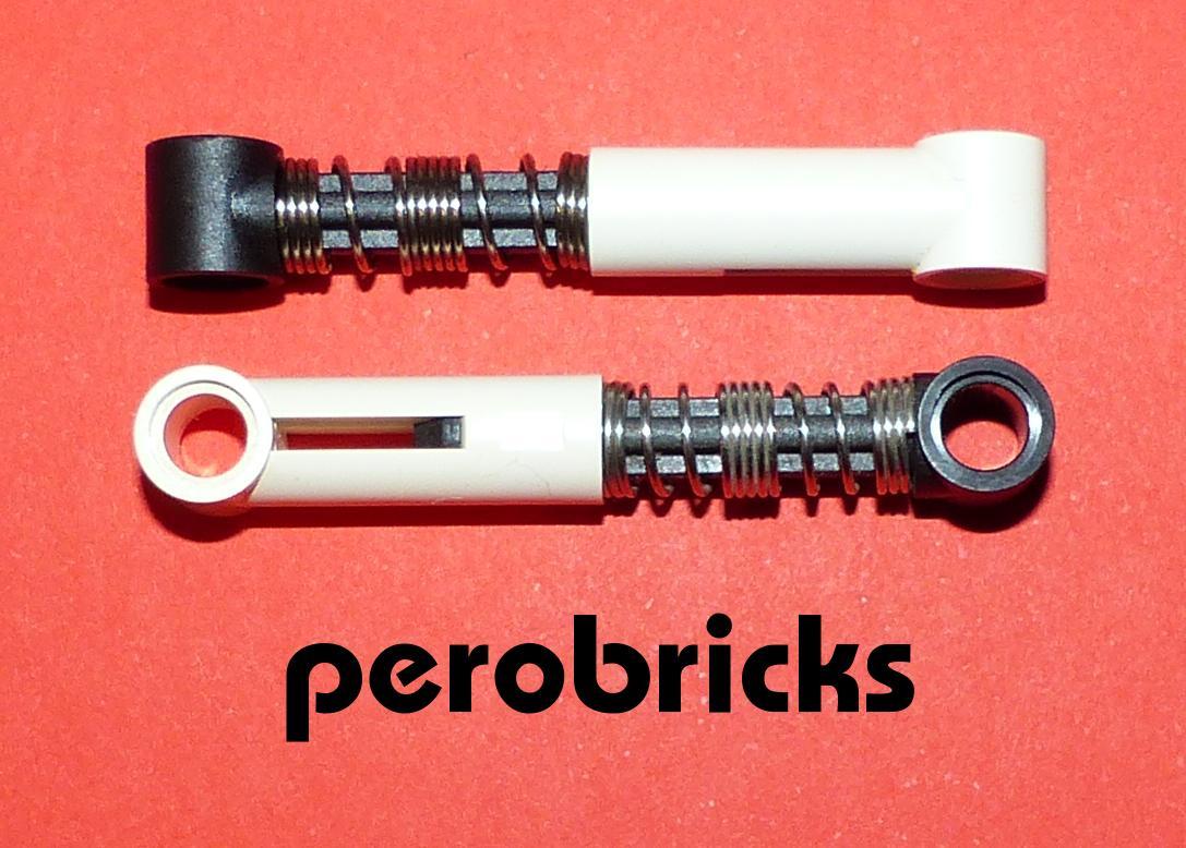

Bricklink lists several sets with an so-called Undetermined Spring Type , for example...the shocks in 8461 are listed here, but i have this set and the shocks are the HARD spring type, Part #731c04, the same as 42056 in Red housing or the Yellow version housing.
Why does Bricklink say undetermined?....in YOUR experince, is there only 3 official spring types?....or could the 4th one be because of wear and tear?, so visually the metal spring looks different, but in reality its shape has been altered due to age and wear?

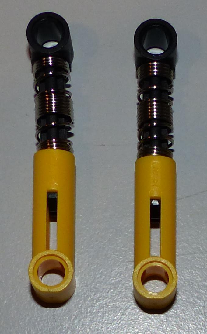

On this picture
The one on the right has a stiffer spring and I got two of them from THIS SET, I use them when the regular ones are not stiff enough.
I am pretty sure the one on the far left is from the old technic studded sets and are softer. I do not know about any other ones.
I've found many 'inconsistencies' in Bricklink's inventory and parts' names. I used to double-check with peeron but that site is no longer maintained regularly.
I think the reason there is a confusion differentiating the springs is due to lack of an easy way finding their stiffness. Some sellers do not differentiate between close but obviously different moulds of the same part, which is kind of easy to spot. Can you imagine such person would be getting into hassle finding out which spring is used in a shock? I doubt it.
It is easier to spot the difference once you have one of each type. But you have to have them, which might not be always the case.
I didn´t know the colors are as much differentiated. The right color coding would be helpful especially at this part to determine their hardness. Instead we get a new hard shock absorber e.g. in the Porsche in red color. Moreover I have noticed they are even a bit harder than the yellow hard shocks. Confusing...
The Hard springs were in White on 8461, Yellow on 42039 etc. and Red on 42056....i haven't seen any other hard springs types in other colours. I think the confusion as to what is a Normal and Soft spring. Visually the springs might look different also. And i haven't touched the longer 9.5L shocks on 9398 etc. there is a wide variety of those as well....with Soft, Hard and Extra Hard springs in different colours.
I have several types, i have Red, Dark Blue, Light Gray, Light Bluish Gray and Yellow....i don't have any Teal or Blue ones. In the 9.5L in have Yellow/Black and all Black, i also have Red/Black shocks as used in this set: http://www.bricklink.com/catalogItemIn.asp?P=2909c02&colorID=5&in=A
