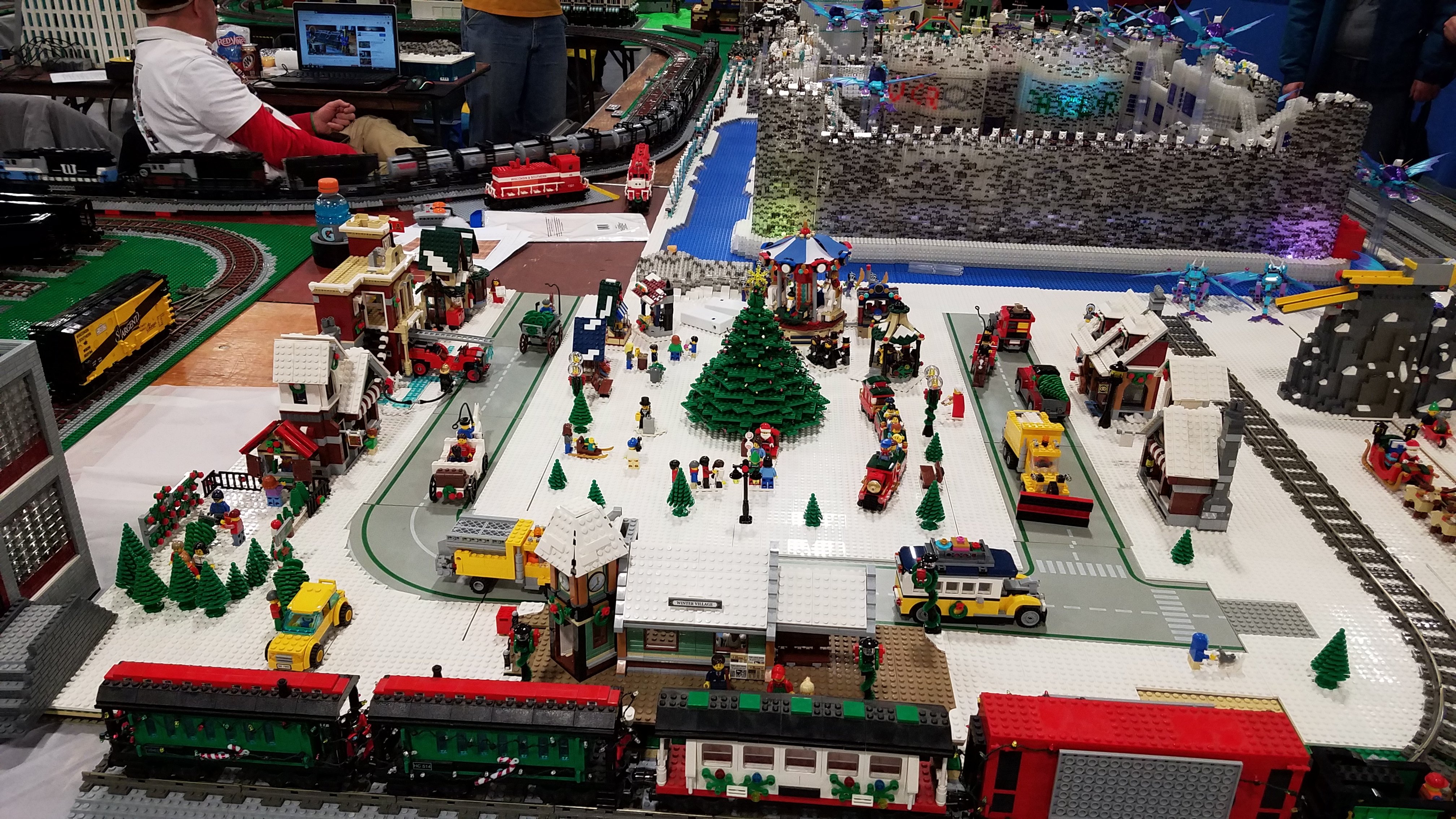

  7. I doubled the height of the tree from the original Toy Shop set, and added mini Christmas lights. I think it makes a nice town Christmas tree in my park area. Sal WFB, WI
