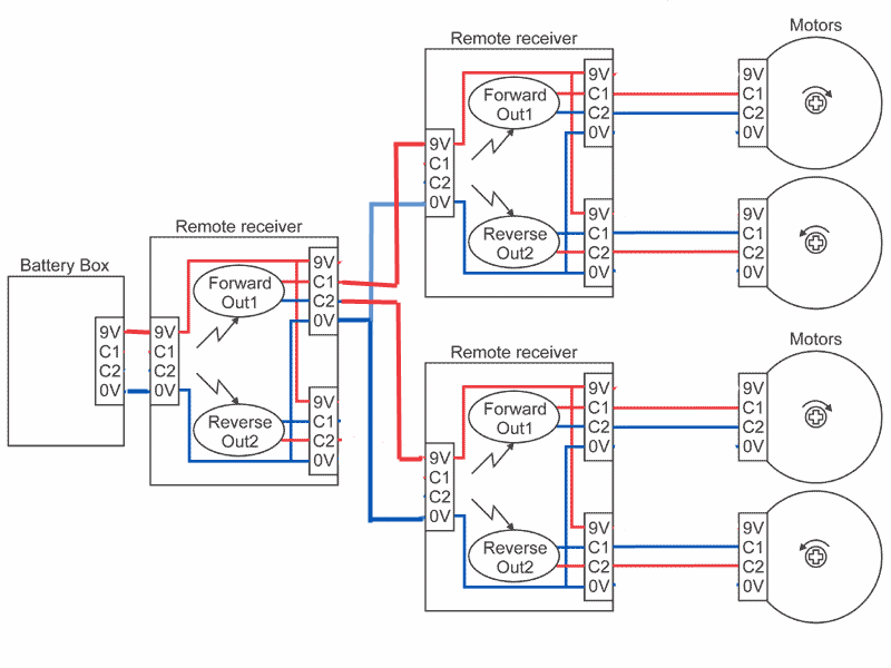

  11. The only way to use remote on remote it to change the cable see improvised schema. Normal the outer powerlines are used, the inner is used for the motor, as it can reverse polarity. With a small change you can use it to power the remote The only negative I can think with this system is as C1 and C2 can deliver total 1000 milliamp of power. So XL motor's are out of the question. As in the other topic, a switch can be used as well: Then you can use a motor with remote to control the switch, and not have the 1000milliamp problem

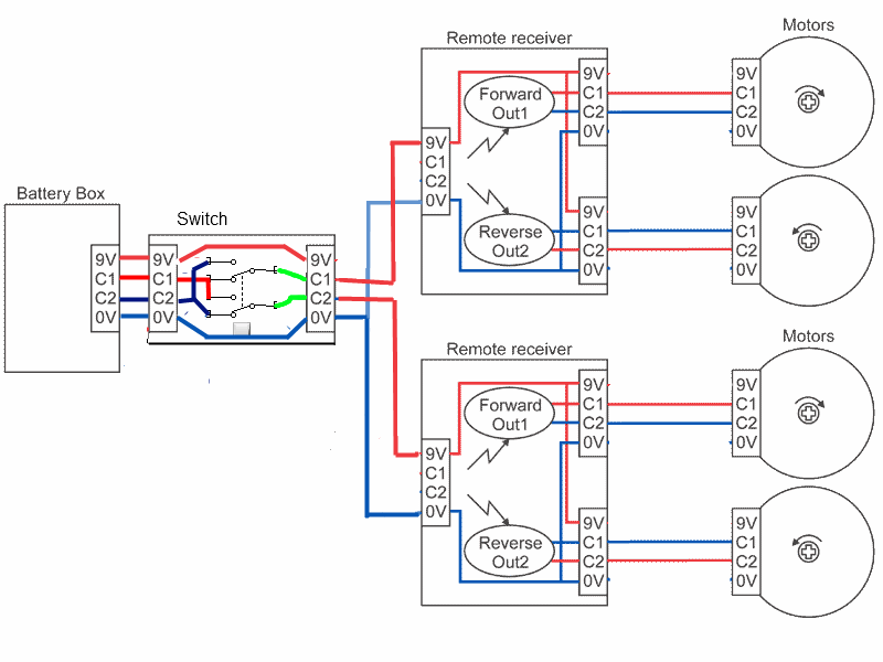

  12. You could use the switch, it changes the polarity, you could use that to power the receivers, but you have to hack the extension cable
