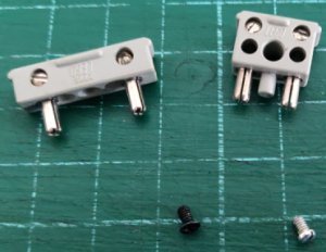

Well i also have some connectors and a caliper :). It seems to me they are M2 with a tap of 3 mm. I tested it with a set of small screws i have. I used M2 length 4 mm (the black one) and they work perfectly. So the scrub screws you suggested should work too. Just pick M2 with a length of 3 or 4 mm. Another observation i have is, that the connectors (the metal part) are very similar to the miniature bananaplugs of 2,6 mm. Like these: https://eshop.microrama.eu/en/test-benches/400-2-6-mm-male-banana-plug-set-of-6.html Maybe they could be used to replace a missing inner connector. Kind regards Jeroen -
