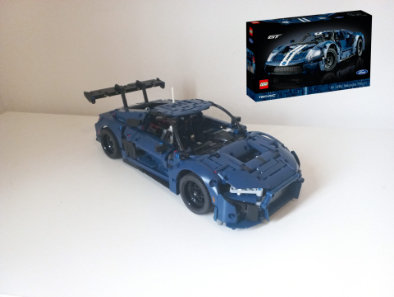

  12. I present to you my latest project: the Audi R8 LMS GT3 alternate build of the Ford GT 42154 set . The track version of the popular Audi R8 super car with a tighter race-focused suspension, performance transmission, stripped interior, improved aerodynamics and a huge rear wing that you cant miss! All these upgrades make this car a true powerhouse in the GT3/racing division. This is truly one of my favorite track cars of all time which is why I tried my best to capture all its glory in Technic form. This project is a culmination of 3+ months of trial and error and trying to recreate every detail of the car as accurate as possible (with the limited pieces) and making sure the car is very stable. I had so much fun designing this MOC and learned a lot about the car's design elements! Rebrickable https://reb.li/m/171899 Features: HOG steering Independent suspension Working V10 engine Detailed interior Differential Opening engine compartment Opening door mechanism
