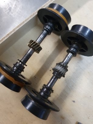

I wouldn't want bevel gears from metal ever again given my findings, as I believe the pairing brass-worm-gear vs. plastic-bevel-gear is "safer". If one would have suitable plastic bevels available from other sources (not sure if 3D printing is fine enough to produce such delicate structures with sufficient precision?), they would be the "sacrificial" part in the combo and are (relatively) easy to replace. Replacing worm gears is way more complex and risky. If the motor itself drops or you slip with your tools you may damage the commutator disc, and that's more or less it then (there is a guide in German here on how to steal such a disk (and commutator) from a different kind of motor, but that's quite a job). So the motor itself with the brass worm gears is the "holy grail" to be protected by all means I'd say. -
Hi all. I have about 5-6 open (now "screw-able" ) 7865s and on two of their shafts I have brass bevel wheels (and on the motor shaft brass worm gears in all cases). All other shafts have white plastic bevel wheels. I never saw any photos of brass bevels I think, and could not g**gle it. I didn't pay much attention and had one brass and one plastic shaft combined in one motor. After a large number of rounds I noticed that one shaft was rotating freely. Opened up and damn! the worm gear running on the brass bevel was completely f*cked, nothing left of the spindle. The bevel looks undamaged. So, the brass bevel is a worm-killer. But ... it must have come out of one of my motors, I definitely have not bought them and swapped them on. I must have cross-swapped the brass shafts out of that source motor into the other motors at some point. I *believe* the brass ones may have come out of my very first motor (with fixed, non-removable pin on top), received in 1983 with my beloved 7740 under the tree. That one lost a worm gear in abt. 2014 when my little one tested her strength against the train, holding it in place while it was at full ahead. (After that my misery ("addiction" in psychology I guess) started, as a replacement Motor had to be sourced, doubling the track length when coming with a lot of extra track . . . don't ask how many more meters, trains and motors there are today, just don't ask please (and don't tell my wife!) :-))) ) The other brass bevel shaft sat in a red motor safely stored and hardly ever run since I fixed it - luckily. Will swap that one out for a plastic one immediately to not risk more worm gears. The question is: which types of 7850 came with brass bevels, and is there a difference then in the worm gears that came with them? I'm afraid there might be a mismatch from plastic bevel matching worm gears versus those that originally were in that brass bevel motor. I can't check it any more, as that original motor took damage to the commutator- fixed ring plate later on, and donated it's remaining worm gear to another motor. "All a mess" , sorry. Also, does anyone have the correct specs for the bevels (plastic ones more importantly) and the worm gears? I never saw any modulus or ratio figures. Bevels have 18 teeth in both variants, and overall dims are easily measured. But detailed teeth and worm geometries not. It is not a modulus of 0.4 on the worms, I know cause I guesstimate that and got hold of two worms with that ratio, but they are different. If we had those numbers... Or, if we had alternative similar matching pairing of bevels and worms available from the hobby train sector... swapping worms and bevels off the lego shafts is doable. Only the parts need to be found. Anyone of you experts? Have a great day! The white one has obviously suffered and isn't usable any longer. Not sure when and where that happened.
