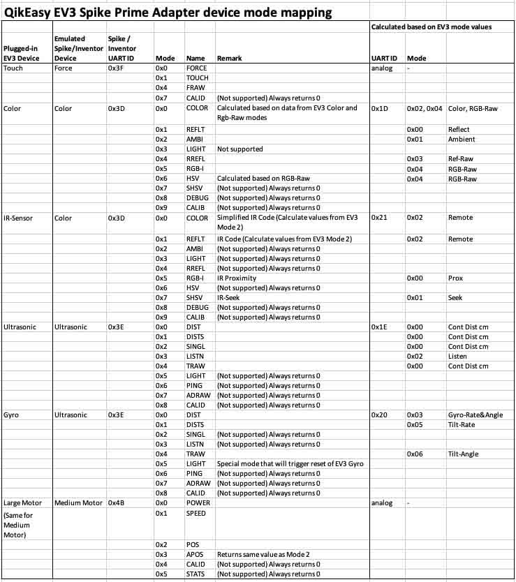

  8. @BrickTronic See attached table for device mode mappings performed by our Adapter board.
