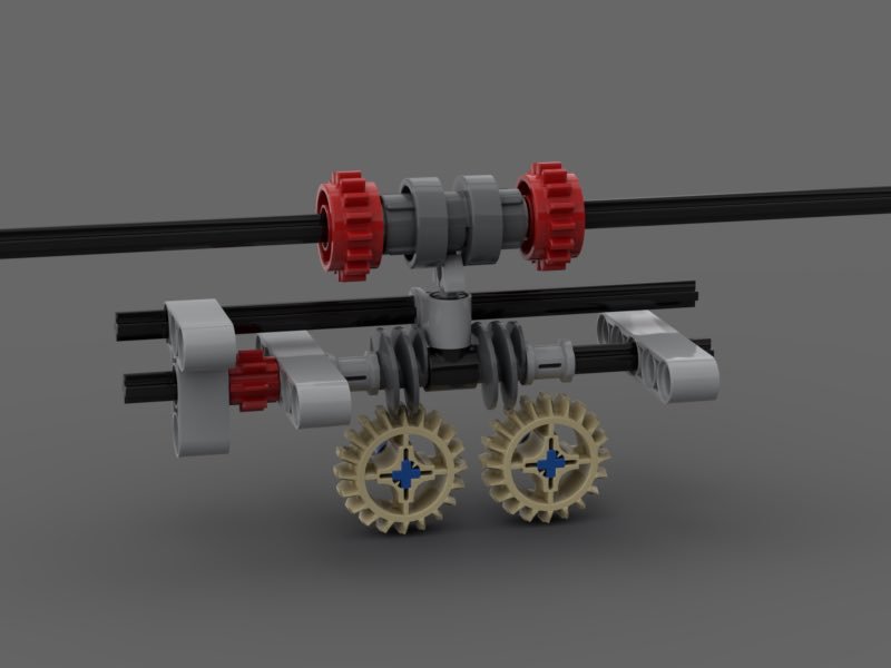

Yes, exactly. Exactly. Here's a picture. Select gear by driving bottom axle. Depending on direction, the worm gear travels to the correct z8 gear which drives the white "paddles," which in turn flip the changeover catch. No constant pressure, since the white paddle just keeps spinning until the input axle changes direction. [edit: image removed] Edit: as you can see, I used your suggestion for Sariel's pneumatic autovalve. It worked perfectly and is very reliable. It didn't fit all of my constraints, but it was such a good solution that I solved them in another way. I do. I guess I could come up with a new system to have the worm gear select between states. That requires a half-turn though, so I really don't know how I'd approach that. Those little paddles sure won't do it! This subsystem will actually experience very little load. The problem is that a lot of torque is taken up elsewhere, so there's not a lot to share. (As in, sometimes a motor will be switching many of these at one time.) So torquing up will mean a lot of stress "upstream." That's why I'm looking for a solution that puts almost zero load on the motor. Thanks for the thoughts so far. -

Hi everyone, My motorized gearbox is coming along well, but I have a new issue. I have a motor that needs to flip several driving rings at once. I could gear down and up the torque a lot, but I don't want to break any axles. Currently I'm putting the driving rings on the white 18948 Driving Ring Connector. I'm aware that I could put them on the gray/black 26287 Axle Connector 3L, but this offers no assurance that the driving ring will stay engaged with the clutch gears. So I'm looking for a way to keep the driving ring engaged with the clutch gears that requires very little force to overcome. One possibility I considered was sandwiching a square-profiled part between two parts connected by an elastic band, a solution I've seen in various stepper mechanisms. Unfortunately, this requires a quarter turn to be effective. The changeover catch only completes about a sixth of a turn (?) when flipping between the two extremes of the driving ring. I could use this solution if I geared up the changeover catch axle at a 3:2 ratio, except this would introduce lots of backlash. My dream solution is a Driving Ring Connector with smaller "bumps" to overcome, but I don't modify parts. Any ideas? Thanks! -

The position of the output doesn't matter so much, but I need the current functionality that if the worm input is going one way, one of the tan gears rotates, and if it's going the other way, the other tan gear rotates. If I just took the input and outputted it straightforwardly, it would always be rotating in one direction or the other. -

That would likely save space, yes! Thanks for your input. Unfortunately, it doesn't solve the issue of the slow output speed. I currently need to gear up the output from the tan gears from 1:20 back up to 1:1. The 20:1 gear-up requires 6 gears to accomplish. The solution you linked to would need either a 12:1 gear-up or 8:1 gear-up. Both of these also require a 6-gear train to achieve. As I said, it's significantly more compact though, if I can figure out how to get the rotating liftarms to engage correctly with the red shift lever. Shouldn't be too hard. Thank you again! -

Hi all, I'm trying to make a motorized gearbox – this is nothing new, but I have a special constraint. Due to the rest of the model, the motor changing the gears can't turn on and off. Continuous forward should change the drive shaft into first gear, continuous backwards should change into second gear. Here is my current solution. Select gears by rotating the red 8-tooth gear clockwise or counterclockwise. Both bottom axles slide left and right together along with the catch that interacts with the driving ring. There are a couple of problems with this build. The main issue is that I want to use the output from one or both tan gears (currently just held on with friction pins). They are turning at 1/20 the input speed, which is a really awful ratio. Also, if there is a way to get the whole thing smaller, lower friction, or both, that would be great. I don't think any of the above can be accomplished without a totally new mechanism – I think this one is pretty close to optimized (it's about a month of work and help from Reddit user u/Daap72). Any ideas for a novel mechanism would be greatly appreciated! Improvements to this one are also welcome. Thanks in advance for your help.
