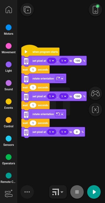

  4. Does anyone know of a method of getting some clarification on what the expected output of programs should be? I've tried going through LEGO Customer Service but I'm not really getting anyway (they also can't receive images / videos via the support emails so that makes it harder) I've been writing some small testing scripts to extract behaviours of the different micropython functions on the hub but some of the outcomes are odd. Here's an example in the app using the blocks: Or in micropython: from hub import display from utime import sleep display.pixel(0,0,100) sleep(1) display.rotation(90) sleep(1) display.pixel(0,0,100) sleep(1) display.rotation(-90) sleep(1) display.pixel(0,0,0) They both give the same results: While I would expect it to have done something like this:
