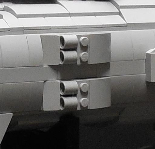

  4. I'm trying (with my limited skillset) to replicate the Andromeda model that was built by marchetti36 in LDD. https://www.flickr.com/photos/10130710@N03/ I've been able to reverse-engineer much of the shape in LDD, but I'm stumped by one piece - and i'm not sure if it's a building techinque OR a new part I can't find in LDD (this model has several parts not available in LDD i've discovered) In particular it's how there are two technic holes mounted facing upward (or outward in this case). He uses this in several places on the model. It looks like some variant of 32530 (Technic, Pin Connector Plate 1 x 2 x 1 2/3 with 2 Holes). What's strange about this is if you look closely, there appears to be a "base" of some sort that would suggest this is a single piece. It also fits perfectly in the 1x2 space of the normal brick (also suggesting this is a piece) The only way I could think to build this would be to take 2x 15100 (Technic, Pin with Friction Ridges Lengthwise and Pin Hole) and mount them to a 1x2 32000 technic brick - but that would not fit perfectly in the 1x2 space. It also won't work in some of the other areas this part is placed. marchetti36 is a genius and it's been quite a task to figure out some of his techniques, but this one really has me stumped. Thanks!
