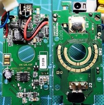

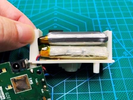

Yes, this is the LINK to the family of products on Taobao. Note, site is in Chinese, and you may need a friend within China to help to ship it internationally.There might be similar ones in Aliexpress, l'll probably try to look for it later. Thanks for the tips... I "drilled" using a screw driver and pull out the plugs limiting access to the screws. Sucessfully opened.... Behold! The cells in all their glory..... or not: Looks like really bad news.... and it seems to me that I better cut them loose and properly dispose of them as soon as I can! Given my lack of tools, can I simply just snip off the 3 cables one at a time? Lets take a look at the PCB: Looks ok to me.... nothing looks fried.... and it shouldnt, since they have pretty much never been used. Pardon the small pictures... but EB limits me to only slightly over 100KB overall uploads per post. -
