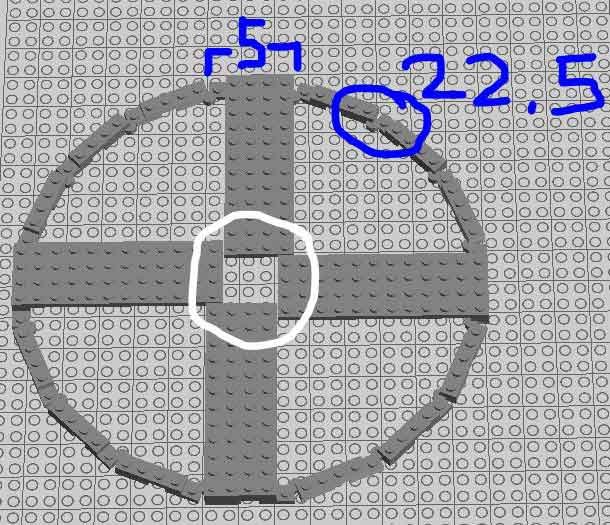

  8. Hey there, everyone, I've been working on a project with multiple 16-sided spires of various diameters. For each of these spires, I am sandwiching the flooring between an array of hinges. Each hinge has the same number of degrees -- 22.5° (360° / 16 sides = 22.5°) -- and each side has the same number of studs. I made one of these that had two studs on each side and it worked fine -- the floor snapped into everything without a problem. Today I tried to make one with 5 studs on each side w/ each hinge set at 22.5°. When I went to add the flooring, it had hairline gaps that wouldn't be there in reality and nothing would snap together. I tried to game the program by adjusting the hinge degrees slightly (22.53°). This worked -- I was able to join the plates, but certain smaller plates on the underside, would not fit. I designed each quadrant of these circles to be identical -- you rotate them by 90° and they fit into one another. I know that if I had the pieces in front of me that I could get them to fit together, but that's not a cost-effective option currently. I really want to make a clean design. Attached is a picture to help you see what I'm dealing with. I'm trying to join the 4x12 plates with an (offset) 6x6 plate where the white circle is. Has anyone else dealt with these kinds of hairline gaps? How did you manage? Working radially definitely complicates things. Thanks
