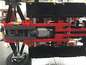

  5. LEGO build completed ... Finally. Reworked the gear coupling between the differential and the motor and it is no longer slipping. Really pleased with the end result ...
  6. hi all, After more than a year away from this ... I found some time to work on this a bit more ... a) After going back and forth between Lego and RC ... I have decided to go with a mixed setup, - 6 Channel RC controller (typical flight controllers) - 3S (11.1V) LiPo power, - Mini servo and ESC for motor control, - but using a LEGO PF L motor. With the right wiring, it can be hooked up to a normal brushed ESC b) I had a good friend 3D print a "housing" for my servo ... This saved space and weight, but was not 100% happy with the angles achieved. Will stick with it for now. c) Preserved the rear differential as well as the front and rear suspension. d) Preserved the V8 engine block and mechanical gears to open engine hood. Lost DRS flap control on the rear wing. e) Preserved most of the cool pipes under the hood. Surprisingly, the whole setup worked quite well ... apart from ... GEARS CLICKING ... so need some re-work ... When I took the car off the floor, and ran it, there was a lot of vibration ... the double bevel gear (20 teeth) sometimes come loose and pops out ... loosing drive ... sometimes it is the motor axle itself that pops out ... This is because I am not driving the differential directly ... but via another set of gears. This is because - a) I wanted to preserve the V8 engine block ... and cannot direct drive the rear differential as it is 1 lego unit too close !!! b) It allows me to play with different gearing ratios from motor to wheels. However, this setup is not great and the whole chassis vibrates quite a bit. It means I have some work to do ... =)
