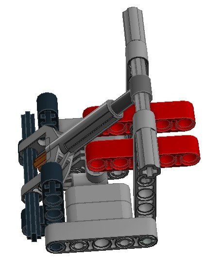

  4. I'm not sure I understand what you're meaning. Anyway I've come up with this solution, I just need to rearrange everything else (again). The orange parts are "Liftarm Thin 1 x 5 - Axle Holes (11478)", and of course in Light Bluish Gray in my actual build. Haven't actually decided which LA to use, but I think the small one has too short range here.
  5. Ok, here is a more complete picture of the lower back half of my tractor. Black liftarms have been repainted in sand for increased visibility. I thought the 42054 Claas Xerion was such a popular set that I didn't need to explain it any further. IMO the only way to motorize this, is to replace the LA with something else. But I have not found a solution. The closest I came was this, but there's simply too much slack to be usable. Lower back half of my tractor: @Gray Gear I used this design so I can use existing Xerion attachments without any modifications.
  6. That won't work because the bottom of the LA is the point furthest away from the tractor. The hitch is attached to the rest of the tractor with the black liftarms in the first picture. So it would look something like this:
  7. You want to flip the LA? That won't work, it will collide with the red colored liftarms in the following image (liftarms moved back to be able to show the picture). The problem with the hitch is that the LA is backwards of what is customary (the hitch attaches to the tractor at the black liftarms). I do have pneumatics implemented in the tractor, but I feel that pneumatics are not suitable in this situation. Pneumatics are either fully closed or fully extended, and they are bad at holding a fixed position over time...
  8. Hello everybody. I am in the process of building my own tractor. It's taken a long time, and I'm not even close to finish. One of the things I've been struggling with, is to motorize the raising and lowering of the rear hitch. I've copied/stolen the design from the 42054 Claas Xerion, so I hope someone has already done this conversion, and are willing to share how they did it. Here is a picture of the hitch design, in case you've forgotten how it is implemented in the Xerion.
