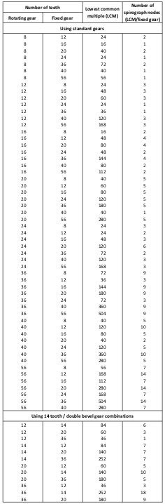

Hi Everyone, seeing these comments got me thinking about what the different gear ratios would do. I've put together a table of all the possible gear combinations and the resultant number of points in a spirograph pattern. I've treated the 14 tooth gear combinations separately, since these can only mesh with double bevel gears (as far as I know). The maximum number of points is 18, when you rotate a 36 tooth gear around a fixed 14 tooth gear. Apologies for low quality image--I had to resort to a low-res jpeg to get the filesize small enough.
