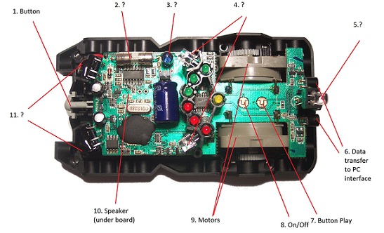

  1. Back then I got few modules, and kids have enough fun playing them. It is a cheap way to get some remote RC motors for cars(or duplo trains) or stationary objects (cranes, etc). Unit+RC cost about 10-15 euro on bricklink. First some answers to my original questions, if someone hit this page: 1. Does color matter? No, they are exactly same inside. 2. Do rc have any channel setting? e.g. if i have 4 RC, will they conflict? There are 4 channels and each unit/RC could be linked individually. Also it is possible to link multiple units to same RC. 3. Do i need only one data cable? As i understood it suite to all colors. Didn't managed to get one. 4,5,6,7 It was too hard to find working cable/software, so i gave up here. -------- Now more interesting things that I recently discovered :) You could fit NodeMCU (arduino like with wifi) to the box. It will need microusb hole, for uploading programs, and could run motors (on 3v) without shield. Making new board and moving components to it, could ad new live to the units. I attached image of internals. Button. Completely coupled with case and board. Could be used to detect touch with adding technics parts. ? ? ? ? Optical interface for data transfer. Button play. Button On/Off 2x motors. Speaker attached bottom of the board. ? 7 leds (3r, 3g, 1y) What i learned from internet (http://www.bricksinmypocket.org/2009/06/spybotics-internals.html), there are next components: light sensor 2x IR receivers laser LED (VLL) 4 IR transmitters Any ideas what is what?
