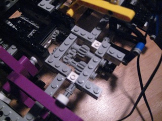

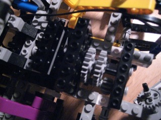

The 8865 gearbox is what mine is based on. The gears kept not being lined up right when I tried to change functions -

Efferman: Dang, I was afraid that those special gears would be the only way to do it. I wish I had them. Mortymore: I already have it so it can walk and turn, I guess I'll just live with having to manually fix the gears when they get stuck. And also, I though Sariel's ten speed gearbox was complex, but I guess it doesn't have reverse Telecasterman: It was done before this, I was just wondering if there was any way to fix this problem that didn't require the specially made gears. I tried to make legs myself but after a while of it not working looked around and went with this design. Apparently the problem was the legs I made didn't have the correct dimensions <object width="425" height="350"><param name="movie" value=" name="wmode" value="transparent"></param><embed src=" type="application/x-shockwave-flash" wmode="transparent" width="425" height="350"></embed></object>Thanks for replies [Edit]Oh! While I'm here. There's a weird thing happening with the pneumatics in the walker. I used Sariel's pneumatic autovalve so I would only need one motor to control that (It takes two motors to make the legs move or there isn't enough power). It works well, but for some reason, when I run the motor one direction, the piston moves very slowly. It is fine in the other direction though. Very odd. -

For a week or so now I've been working on making a walker based on Theo Jansen's designs (Actually, after I couldn't get the legs right I based them off of someone elses' leg designs). After I made a simple four legged thing that just went forward and back, I wanted to make one that could turn and could be remote controlled. The problem is I just got back into technic after not touching legos for years (It was this project that brought me back), and I am very limited in the pieces I have. I have the mindstorms brain thing, but I'm not sure if I have the software to program it anymore, and either way I kind of decided that I would go without it anyway, kind of as a challenge. So I have three Mindstorms motors driven by one of the large controls for the lego trains and some pneumatics. The first and second pictures attached show the little gear box thing I came up with so the robot would be able to turn. The top gears in the second picture physically move forward and back to engage the gears in the first picture, giving two combinations, turning and straight. The gears are shifted by the piston in the third picture. And now my question. The main problem with this is that occasionally when I'm trying to shift the gears the top two will get caught on one of the bottom ones that are unaligned, which then causes the piston to just snap the part it's moving, or the motor running the piston will just fall off. I'm wondering if anyone knows of any way that could keep the gears aligned so they don't get stuck when they are moving. Hopefully there is a way that doesn't involved purchasing anything or using any unusual parts.
