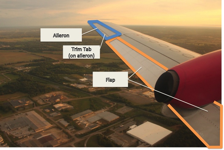

Can any one add arrows to show me or can tell how they can add flaps during flight?
If you look closely you can see the bottom of the engine cover is part of the flap section.

I've attached a picture with the ailerons and flaps labeled.
-The ailerons are towards the tips of the wings and control the roll of the plane. They move up and down.
-There are also trim tabs on each aileron, and they allow the pilots to make fine adjustments that control the level flight of the plane. They move up and down. Not really necessary on a LEGO model, unless you want to add that extra little detail.
-The flaps on the Saab340 appear to be a single flap on each wing that runs beneath the engine exhaust. The flaps provide additional lift at low speeds. The Saab340 uses single-slotted flaps with offset hinges. They move down. They don't move upwards (unless being retracted of course).
The Saab340 does not have spoilers.
Hope that helps! Looks like an awesome project!
