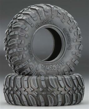

VKTechnic Posted August 30, 2013 Author Posted August 30, 2013 Hi, Why not build something similar to 8081 and turn it into a crawler? For your chassis I would try a shorter wheel base. Keep us updated with your progress. H PS: I just looked at your photostream. Excellent work. I'm keeping the wheelbase a little longer because I plan on buying some third party tires hopefully within the next month, and they're going to be noticeably larger. Quote

VKTechnic Posted August 31, 2013 Author Posted August 31, 2013 Worm gear are good for getting a large reduction into a small space, but are terribly inefficient and the knob gears aren't too good either. What gear ratio you use depends greatly on what motors will be used. You don't want to gear it down too much and loose wheel speed. Gear it to get the torque you need and satisfy yourself with the resulting speed. v/r Andy In crawlers I usually like to have low wheel speed -- I'm going for one L-motor and a 24:1 gear reduction. For tires I'm thinking these or these tires. Quote
