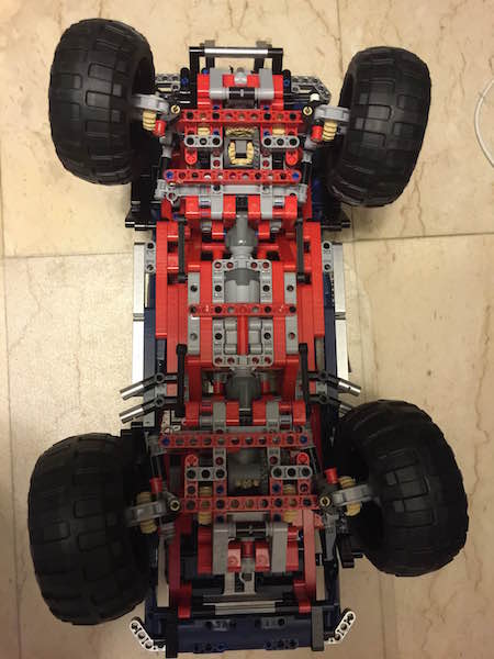

dchua70 Posted August 30, 2016 Posted August 30, 2016 Hi all I've completed my built of the Crawler and when i switched on the power, the front wheels are turned to the left and rear wheels are turned to the right. that seems to be the default rest position. When using the remote to turn right, it only manages to straighten the wheels and will not turn right any further. How do i fix this problem? Thanks. Quote
syclone Posted August 30, 2016 Posted August 30, 2016 (edited) Have you built it correctly? For perfect alignment the servo and the wheels must be centered while building Edited August 30, 2016 by LXF Quote
MikeTwo9398 Posted August 30, 2016 Posted August 30, 2016 Maybe you forgot to "zero" the Servo motor before building it in steps 1, 2 and 3. You might be able to fix it by remove the axels build in at step 27. Move the steering and shift it to the correct position. Quote
dchua70 Posted August 30, 2016 Author Posted August 30, 2016 Thanks guys!....with my very limited knowledge but thanks to your pointers...I surprised myself and managed to fix it without having to tear everything apart! Happy camper! :) Quote
