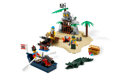

The_Cook Posted May 21, 2014 Posted May 21, 2014 Raised baseplates? Are TLG still producing them? Can our set designs include them? Quote
Governor Mister Phes Posted May 21, 2014 Author Governor Posted May 21, 2014 On 5/21/2014 at 5:54 AM, The_Cook said: Raised baseplates? Are TLG still producing them? I was hoping you could tell us that... 6241 Pirates Loot Island from 2009 was the last pirate set to have a raised baseplate. Quote

The_Cook Posted May 21, 2014 Posted May 21, 2014 On 5/21/2014 at 6:59 AM, Mister Phes said: I was hoping you could tell us that... The day job gets in the way... The more recent sets all appear to have used a higher density injection molded plastic, eg. the loot island base or the baseplates in the Bionicle sets; this differs from the blow molded thin plastic baseplates of the 90's. I've posed a question in the Historic forums to find out if the recent baseplate for the Kingdoms Chess set is blow or injection molded. My gut feeling is that Lego have moved away from baseplates; even flat baseplates are rare these days the preference being for large 8x16 or 16x16 plates since they are more rigid and more flexible. Smaller plates require smaller boxes which saves on packaging and transportation costs; the exception is the larger creator expert sets (the modular buildings series and the Sydney Opera house) which utilise baseplates but have sufficiently large boxes that it doesn't matter. My research hasn't been exhaustive, someone might be able to prove me wrong. If the old baseplates are no longer being produced and we've already said no to new parts then we'll have to work to that constraint. I would urge the designers to look towards the castle sets like 8877 and 7094, 7097 to see how large panels can be utilised to quickly build height and bulk in a set. BURPs might just be your friend! Quote
The_Cook Posted May 23, 2014 Posted May 23, 2014 Faefrost responded in the Historic forums. It would appear that the raised baseplate in the latest chess set is indeed a vacuum formed piece rather than injection moulded. However is should be noted that said baseplate does not contain any studs, it's merely a receptacle for a standard baseplate that fits within; therefore it does not need to be made to the same tolerances as a true baseplate. The last set with a baseplate was Scorpion Pyramid in 2011 as part of the Pharoah's Quest, so TLG must still have the machinery to produce them. Therefore I supposed we can utilise them. Quote
