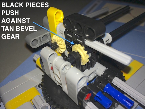

I need some help with my Technic Logo 42009 Mobile Crane MK II. I am working on the "cabin" section of the vehicle. I will refer to Book 4 (of 6) here.
Everything is good through Step 17 on Page 8.
Take a look at the tan bevel gear attached to the long black rod. At this point I am saying things are "good" because rotating the black rod with my fingers freely rotates the bevel gear - which, in-turn freely rotates the black spur gear. Excellent..
Moving on to Step 18 we make a separate assembly. The black "T" shaped piece will begin the problem.
After mating the two assemblies (see below) the gears no longer turn without significant friction.
I thought the problem would just go away so I proceeded. A few steps later, the black rod is now under so much pressure it tilts up significantly. Game over.
I took it apart and retried assembly three times. I cannot figure out what I am doing wrong. Any ideas out there? Anyone else run into this?

It looks to me like you've left too much space between the tan gear and the 1/2 liftarm. I doubt it's as simple as pushing it up a bit, but that's all I can see from here really

Make sure that the bracket that holds the troublesome gear is secure - it looks somewhat tilted. There is a tan 3/4 pin that holds it to the frame that's pinned to the turntable, but I can't see it in your picture - if it's there at all it's not properly seated.
It looks like the tan 1.5 pin is mounted backwards, or the bracket isn't pushed into the pin properly. That is offseting the bracket.
DING DING DING DING! GIve that CITIZEN a cigar. Reversing the tan pin solved the problem! The tan pin is added on Book 4, page 6, step 4.
