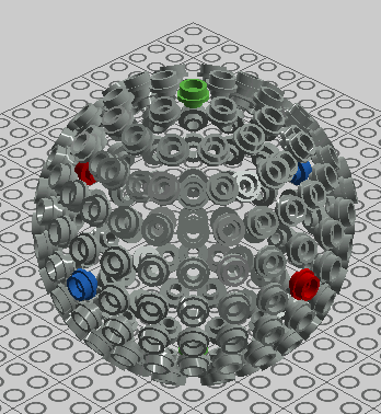

OLDNUT Posted June 13, 2014 Posted June 13, 2014 The pic is the final result of a study into the transformations twelve CSV. This study is build on the knowledge supplied by the contributors to Gnac’s post. The sphere is 202 1x1 round brick with hole #85861. It confirms my suspicions that CSV twelve are nine trigonometric functions and three real coordinates. I used a spreadsheet to make the calculations and generate the LXFML file. Thanks to bbqqq for sharing the process he uses to generate the random min figs with decorations. Quote
The_Cook Posted June 16, 2014 Posted June 16, 2014 It confirms my suspicions that CSV twelve are nine trigonometric functions and three real coordinates. Correct it's the 12 values needed to produce an affine transformations in 3d space. As an aside: theoretically there should be 16 numbers, the last 4 are used to skew and shear the geometry but since physical plastic bricks can't be skewed those additional numbers aren't required in LDD. Whilst there are many tutorials on-line that describe the affine transformations my personal preference is for: 3d Computer Graphics by Alan Watt who I always felt presented a fairly readable introduction to the topic. Quote
