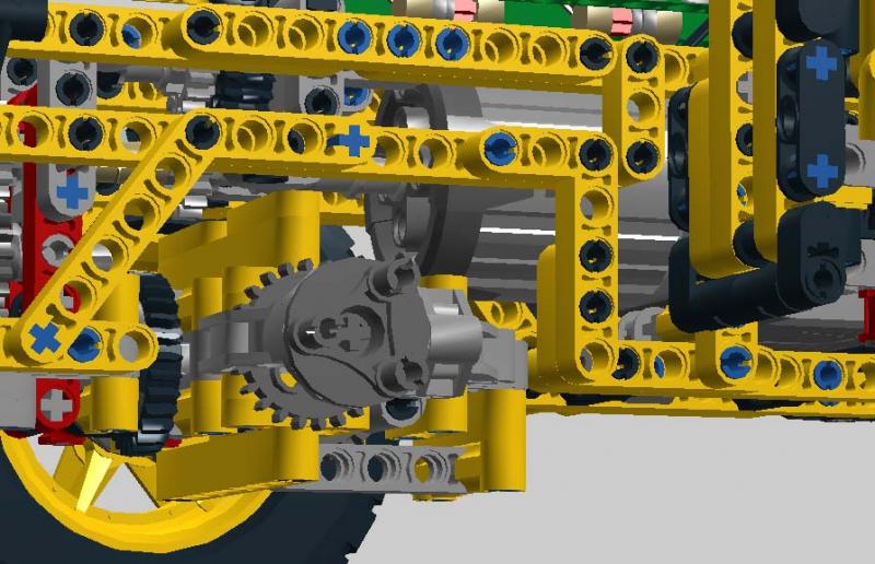

The planetary gears are used in real life because they represent a more robust way of getting torque to the final drive. The amount of torque is a function of the overall gear reduction from the motor and frictional losses. So if you use the same motor and use the same final gear reduction at the wheels - ignoring friction (which will not be much different unless you use a worm) then the torque will be identical.
The planetary gears provide a way actually doing the final gear reduction at the wheel hub which means the torque in the drive shaft and final gearing in the diff/gearbox is less. (Ignoring friction - torque will be inversely proportional to the speed of the axle). If we assume that the final drive in the the lego model can support the entire XL motor torque through a single gear (one wheel - if we could lock the diffs) without ripping apart, then this mod - although elegant and true to life, is not required and does not increase torque for a given speed. (only a torque multiplier can do that - and then we into the realm of hydraulic systems).

Now, where the first reviews are online, i see that i have a higher gear reduction, and the 42030 has more speed. Not sure which solution is better.
