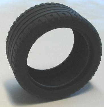

@ bmollema: Both versions of Sicil's Rally Car "Blacked" use 41896 "Wheel 43.2mm D. x 26mm Technic Racing Small, 3 Pinholes" . They come in different colors, with these sets (not the 8070 Supercar). Low-profile 41897 "Tire 56 x 28 ZR Street" are mounted on the wheels. It should be noted that there is no room for a differential on the rear axle; only solid axles are used.
