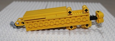

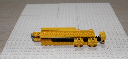

Hi I present my latest creation, a home made actuator.
Very small and fast..
