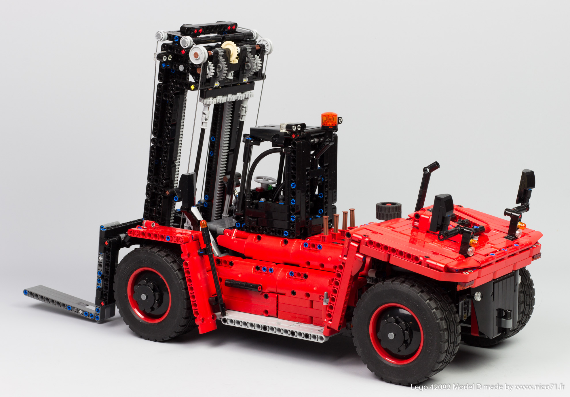

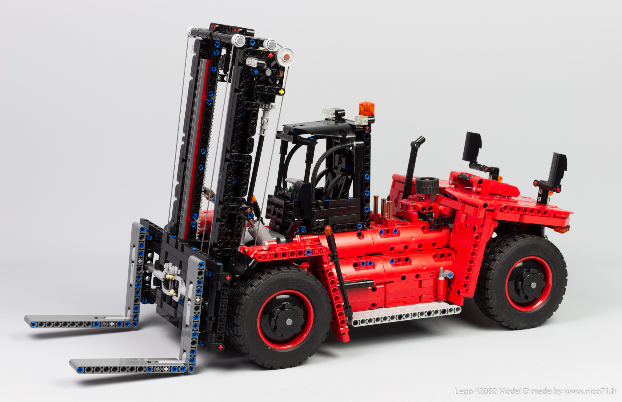

@nico71 wondering if there has been any further progress on the 42082 D model. I am eagerly waiting to see it. Could not find any update on it on your website or your FB page. I absolutely love your creations.
Hello,
the model D is finished, pictures and videos are done, and Kevin Williams works on the building instructions. but this is a huge model so It takes time to complete !  I can not tell at this time when it is finished and published. Here is some pictures :

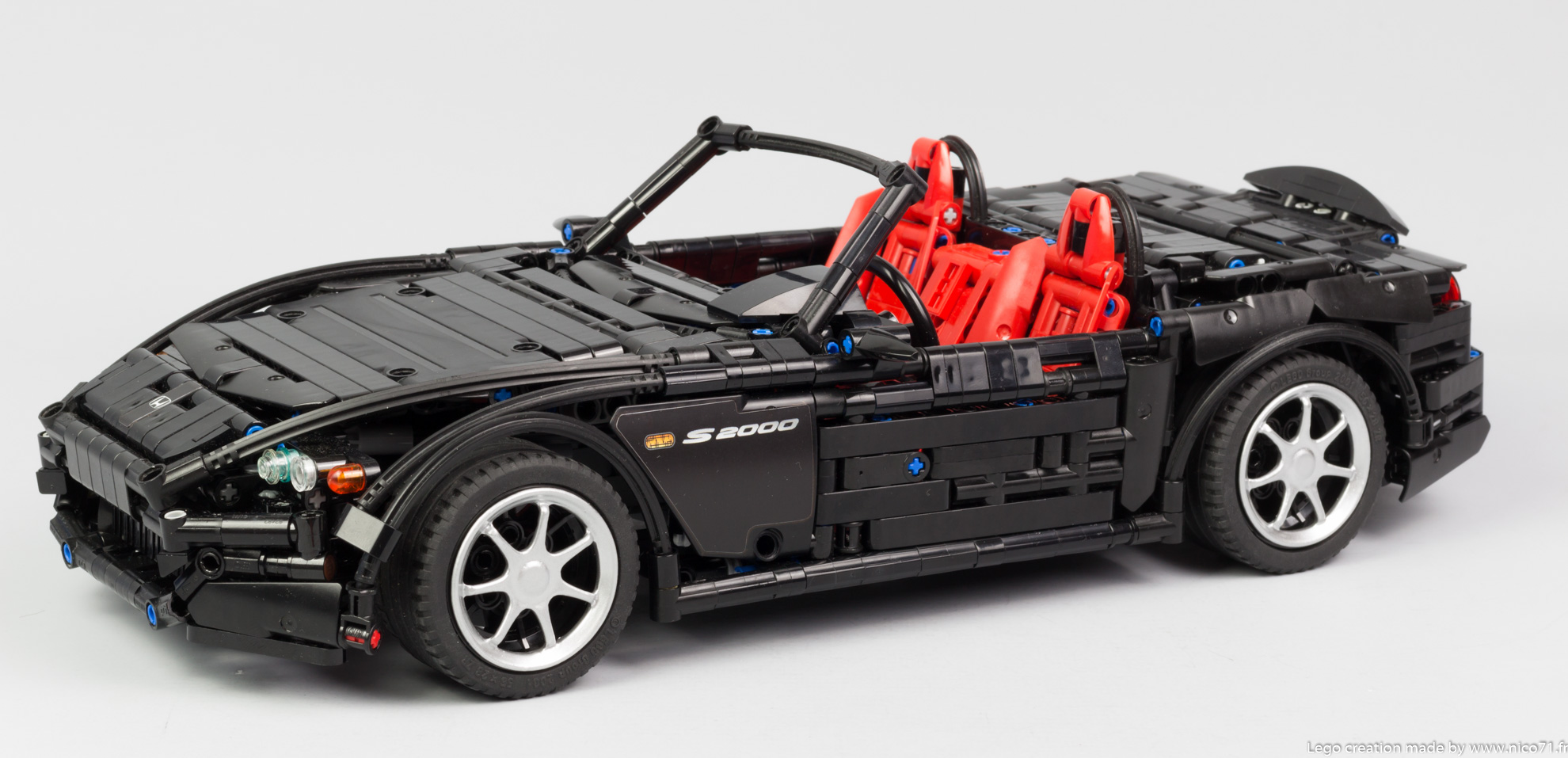

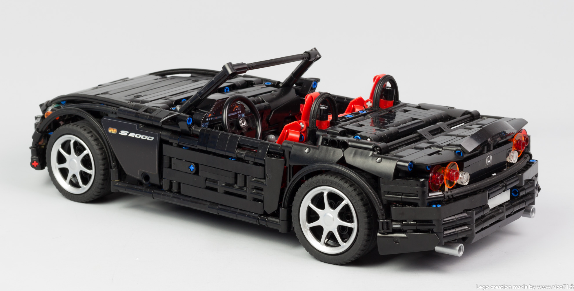

But mainwhile I am working on the building instructions of a new car that I have design in the begining of the year, which is obsviously a honda, a S2000. It represents the best I can do in this scale with the bodywork, it is full of building technique to obtain half stud gap to respect the shape at this scale. You can see some picture here :
I am very proud of this two creations, and think I am going to this type of creation now. Which is model C or D because it is very pleasant to work with limited inventory and making instructions for it (people are really happy with model C) and some other creations which takes month to make but are rather perfect for me. Even if it takes many time to do, this is a way I like, and of course I will not publish many creations / year now. But it worth it I think :)
I am esspecially interested in D model of 42082. It looks great. I see 4 levers, so I assume therea are 4 automatic functions. What is the fourth one (lowering/uprising of the fork, tilting the fork, expansion/narrowing the fork and ....)?
P.S Honda also looks terrific.
You will see soon ^^
Thanks for the comment on the two creations !
Awesome models both! One minor question: why the geartrain and driving axles to the fork elevator are doubled? Only stylistic feature?
Yes for the design, it enables also the driver to see between the two pillars. and also to reduce the torque on each U_join in order they do not take apart.
