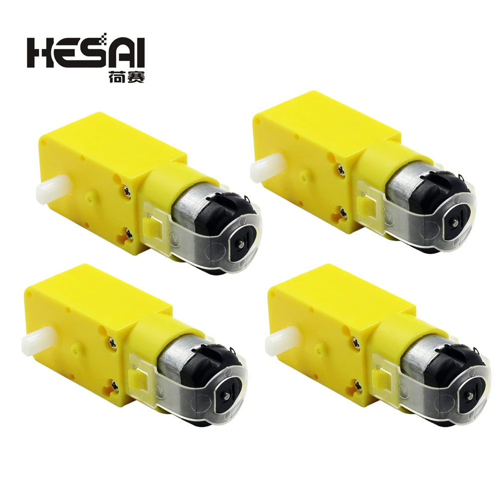

Cyber Master Posted April 19, 2023 Posted April 19, 2023 (edited) Hello, i had found a motor, but it does sacrifice some battery slots and the pcb won't fit anymore... These motors are from amazon. I think they are somewhat common since i can find them everywhere when i just serach for gear motor. Spoiler I made a topic about that... 2 years ago... damn time flies... well i havn't progressed (no time, laziness and those damn chips with like 70+ weeks delivery time...). Topic: Edited April 19, 2023 by Cyber Master Quote
Toastie Posted April 19, 2023 Posted April 19, 2023 (edited) Damned, yes, time flies by ... Very nice solution and nice find! The thing (for me - and only for me!) though is, that you also need to replace the Cybermaster brain. And I don't know, but are these nice motors you found, of the type tacho motor? The original Cybermaster firmware controls the speed (not power) of the motors, as they have a built-in rotation sensor: When you set both built-in motors to speed X, they'll try to maintain speed X, regardless of things that may slow them down. In other words, when you instruct a Cybermaster robot to go straight, it will. When using an RCX brick with two Technic 9V motors on a two wheel robot, it will go "sort of straight", when putting the motors on power X. In any case, nice solution to resurrect old programmable LEGO stuff! All the best, Thorsten Edited April 19, 2023 by Toastie Quote
Cyber Master Posted April 20, 2023 Posted April 20, 2023 (edited) No they don't have a built in feedback (tacho). The motors from lego also don't have a built in tacho, they have a light barrier soldered to the pcb which reaches into the gearbox... so it's difficult to find a motor that uses the original feedback system or an replacement motor which is flat enough to fit on the original gear box. Edited April 20, 2023 by Cyber Master Quote
