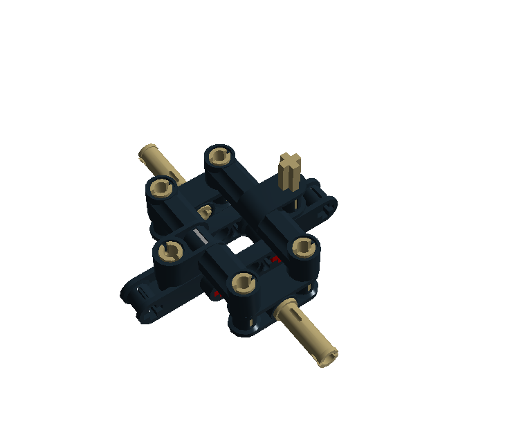

Might be done this way?
Edited by Mephistofeles
Interesting.
Can you attach the LXF please?
(just change the suffix from LXF to ZIP and it will work)

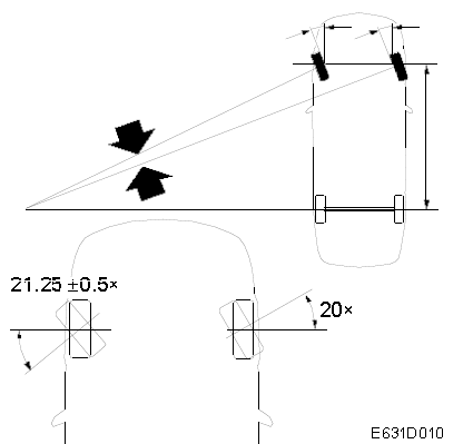

Just to make sure - we are all agreed that the problem is to create a "virtual" turning point that is on the rim center line (see lower images below). This because the turning point with a LEGO-wheel (at least the smaller ones) is far outside the rims center line, so the wheel travels very much forward and backward as it steers. To make a solution with LEGO wheels, the wheel have to rotate around the steer poing AND at the same time the entire steering mechanism have to move foward/backward, thus giving the effect that the wheel turns completely tight inside the wheel well.
And please note, it has to turn completely inside a tight wheel wheel. For example these wheels have to turn inside a wheel well that's 4 studs long. It's an extremly tight fit. 5 studs long could be accepted as well, but more then that and the vehicle will not look realistic.
Having said that, I'm still not close to a solution yet. I see in front of me how it has to work - problem is to convert into a clever LEGO solution :classic:

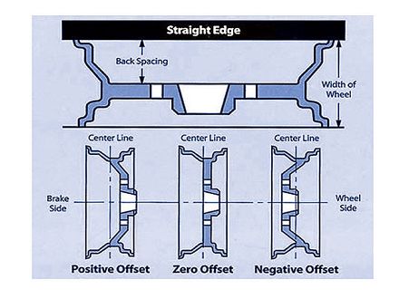

None of these have a steering even remotely similar. The wheel hubs of this cars have a rotation point from zero to two studs from the rim. This gives them a lot better handling then a vehicle with 5 studs between the rotation point and the rim. Ideally the rotation point would be inside the rim, but this would require a different wheel, with negative offset.
As for the turning radius, its larger on the 8110. On the sets mentioned it can even be modified to be tighter. The reason for this is that the 8110 needs a lot of space in the wheel wells because of the 5 stud distant rotation point. This limits the angle the wheel can have, and in addition a large angle on this kind of construction gives bad stability.
What we here are trying, is to avoid these problems by transferring the rotation point to the center of the wheel. This should have been possible for TLG to do when they made new parts, but the result is far from pleasing (in my opinion). Lego lacks a good part to give realistic steering to both large and small vehicles. But at the same time, this is what makes Lego such an interesting challenge; How to make something that doesn't exist, with art we have... For smaller models it is possible, as proven in the buss a bit up in the thread. But for larger driven vehicles it's a recurring problem. The parts used for steering in 8070 and 8297 are good for making a realistic steering in non driven models, but lack the strength for use in a driven model.
