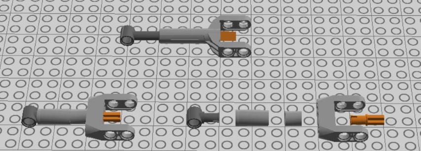

On 2/26/2017 at 11:39 AM, kennywest said:
Sorry to revive an old topic, but I'm sure this will help others, trying to add linear actuators to their models.
I needed some large linear actuators in my model that were not fully extended. The trick is the create an empty LDD drawing, with the actuator in it. Then, save it, without adding anything else. Rename the file you just saved to la.zip. You should now be able to open the file and find a file, called IMAGE100.LXFML. This is an XML file, which you can read or edit. You can also find this file here. Below are the important parts of the file (you can open this with notepad, our your favorite editor):
      <Part refID="1" designID="62275" materials="309">
        <Bone refID="1" transformation="-1,0,0,0,1,0,0,0,-1,6,1.2000000476837158,0.40000003576278687">
        </Bone>
      </Part>
      <Part refID="3" designID="62274" materials="199">
        <Bone refID="3" transformation="-1,0,0,0,1,0,0,0,-1,6,1.2000000476837158,0.40000003576278687">
        </Bone>
      </Part>
When you modify the value 6 (so, the value after -1, before 1.20000...) into something else you will see the actuator is extended or retracted. The LXFML file can also be opened directly in LDD. So you can play with the values, double click the file and you can see the result of your changes.
When your satisfied with your changes, save it and now you can import this into your model, using the "File -> Import model" menu.
I hope this helps someone.
is there a way to also adjust the length of the 92693 linear actuator???
i use it some of my models, tried after reading your post
thank you
You can also export to LDraw in LDD, move the parts in the LDraw CAD of you choice, then reimport in LDD.
Only export/import one of these parts, otherwise, when importing, LDD might mix the parts and not assemble the matching subparts (it’s fun though).
