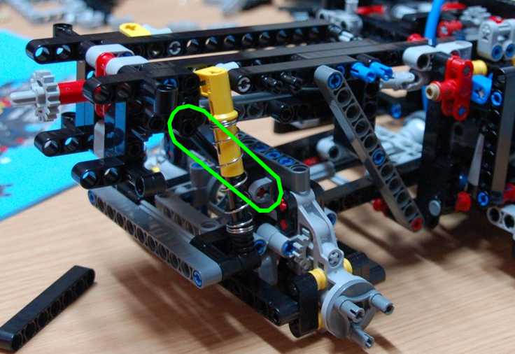

I don't know if this was already explained, but I have been wondering... You can't compress the 2 shocks (in each axis) at the same time can you?
At least the disposition of the steering transmission doesn't let you...
What do you guys think?

They have tought of it. In the following picture of the front it's easy to see how it's solved.
Here you can see that the top of the shockabsorber is connected to this piece:
87082.jpg?2
This gives the top of the shocks possibility to rotate both in X and Y axis.
And in the bottom they have used this part:
And only connected one of the pin holes to give the shocks ability to rotate in both Y and X axis.
In the rear they have chosen a different solution. As you can see of the pictures below they have the same top mount with both X an Y axis rotation, but in the bottom I'm quite certain that the rotation in one of the axes is linked between both sides. I don't know why, but it may be a way to create a kind of torsion bar contradict lurching while turning, but I really can't say. I don't know how this is don on the real thing either, but maybe someone here knows?

Thanks for the quick response Nazgarot but I haven't explained myself well.
Besides of each wheel go up and down in each axis thanks to the scheme you explained, do they both go up and down at the same time?
For example, when you put your hand in the center of the vehicle and push it down, all four shocks will compress at the same time.
I believe this unimog can't handle this kind of compression.
I may be wrong of course.
I am sure it can! Otherwise Mercedes would have NOT :) given the licensing to TLG.
Here you can see the steering transmission pretty clear:
They are using at least one of this part in the steering transmission.
This part does not have a "press-fit" connection with an axle, but a floating one. So the steering transmission can expand and compress.

Don't these rods/beams stiffen the mounting suspension of each axis in a way that permits wide contraction of both shock absorbers at the same time?
There are two of them on the front axle too, iirc.
Edited by Bartholomew
  On 6/15/2011 at 1:39 PM, Bartholomew said:
You've omitted a "not", Gerhard ;-)
Thanks! :o) I changed it!
These links prevent the whole suspension axle to move left and right without control. If this thing is not there, then the whole back axle would swing left and right. And I hope there is only one link-arm on each side of the vehcile, because otherwise the suspension would not work. It would be blocked.
On this picture, you can see, that there are only two link-arms. At least it seems, that they have sorted all the bits and pieces. So they only found 2 of them in the package:
Regards,
Gerhard
Edited by tripletschiee

That is called a panhard rod. Here is a good animation of it:
Edited by legolijntje
Thanks for the correction :)
Yes, two diagonally mounted panhard rod, one for each axle. In the marked picture, I got the perspective all wrong...
In these pics, all is visible more clearly:
