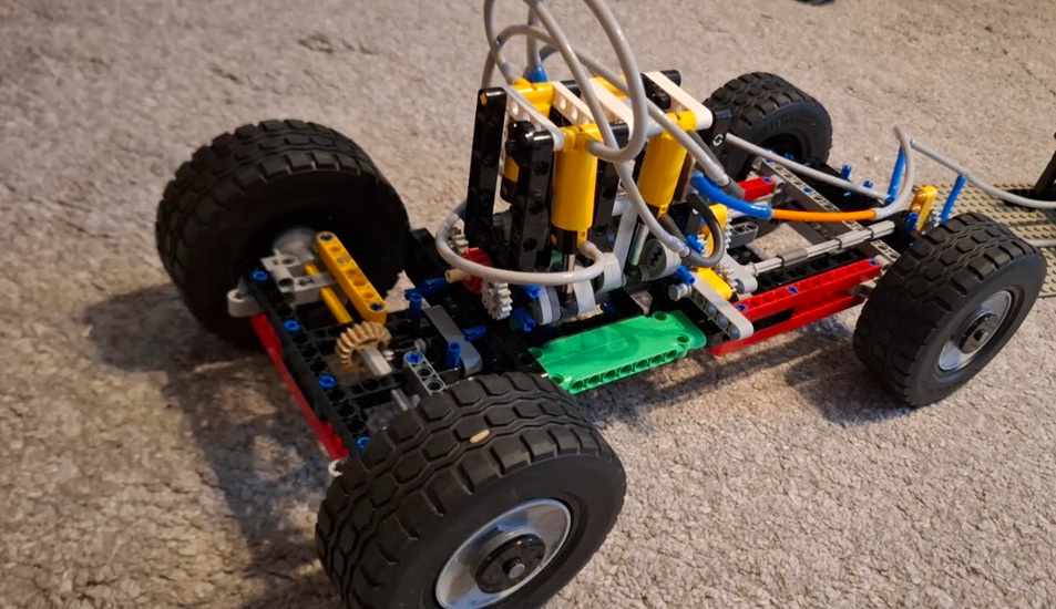

Details
The LPE engine has very low rpm but high torque, so the output will be geared up as much as can be done effectively. Four medium cylinders, one set in 90 degree phase in relation to the other set. This means an engine with no dead point and noo need for a flywheel. This is a common, obvious setup, I didn't invent anything about it.
Since the motor only rotates in one direction, there is a forward/backward clutch, actuated pneumatically. It will be operated with the throtlle lever, and the engine will always operate then there is pressure in the system. The clutch will disengage the drive after a while if presure is not applied. This is to ensure that the model does't break when pushed. It is achived by simply leaking the two pipes that goes to the cylinder that's operating the clutch. Maybe I will put additional safety clutches to the half axles, I have to test that.
Adjustable suspension, solids axles, four links. A very simple one, that uses only one circuit for the four wheels, so it only works when fully pressurized. Otherwise the chassis tilts and rolls. It will use long thin pneumatic cylinders. I estimated the load capacity, and should be strong enough to hold the model.
I will apply limit straps, in order to protect the cyinders when the model is grabbed by hand.
Four wheel steering, actuated by pnematics on both axles. The axles are mechanically coupled (gear-rack). Independent steering would be awesome, but it would be too complicated to solve proper centering (would require two cylinders per axle to make a three stage positioning, and much more complicated control).
The hand pump are part of the controller device, but can be detached (so one person pumps, the other controls).

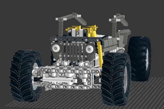

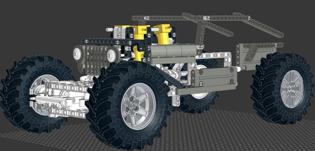

Progress so far:
-The engine prototype is done, and tested with a rolling chassis. Slow, but very strong even without proper bracing and optimisations. The weakest part is the drivetrain, the engine is so strong that it can twist an axle. Lubrication is not applied yet.
-sketches of the whole model in Stud.io. Basic proportions, axle prototypes are made.
