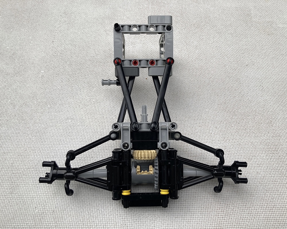

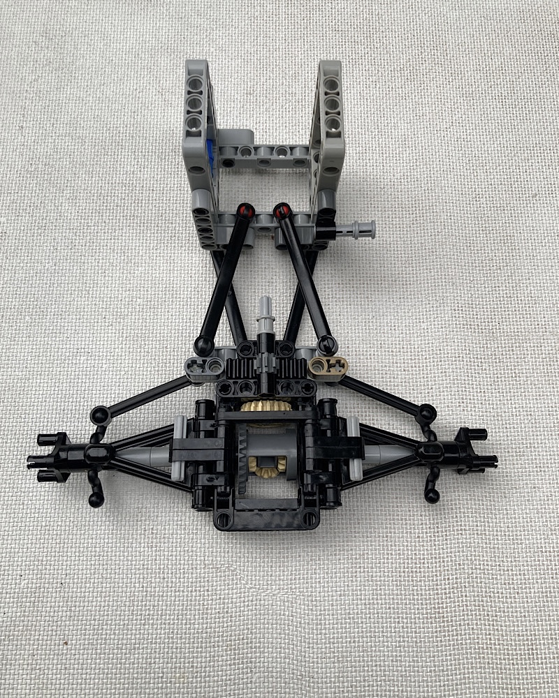

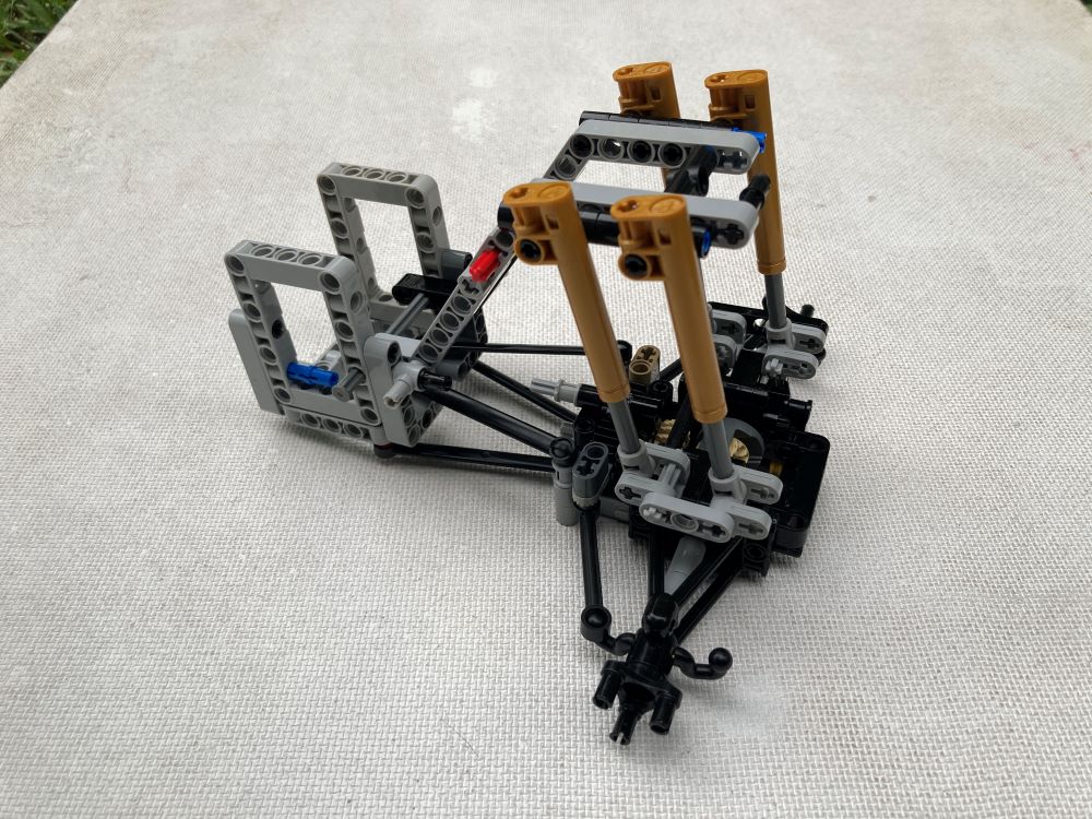

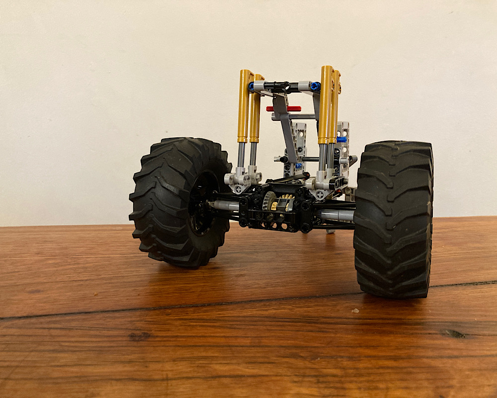

First is the axles as they always are challenging to build and thought I would challenge myself even further to use the suspension arms from the McLaren MP4/4 combined with the wheel hubs from 8386 as I had both lots sitting around and together they make a nice slim looking axle 3-4 studs high trying to replicate dimensions more accurately from usual Monster trucks chassis. The arms were a little hard to form lock in place cause of their design but I cant pull them out in any direction now.

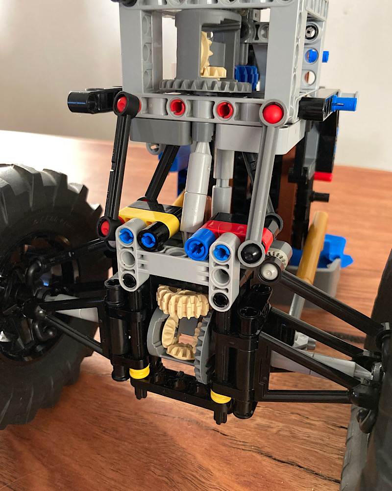

It’s hard to see but had to use 8 long system type steering rack setup for very slight toe in to keep the wheels from doing the usual sloppy, loose, splaying outward thing when pushed forward.
Slight Akerman affect at full lock.
4 link suspension  with the suspension arms creates a very nice appealing look I think 😊
I’ll need a few more of these long gold shocks but they fit and feel nice at the right sort of scale. I am a bit disappointed in the lower connection of them to the axle though as it’s a bit big and clunky looking but can think of anything else at the moment.

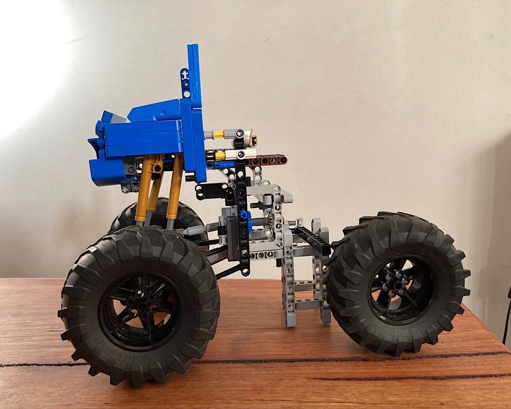

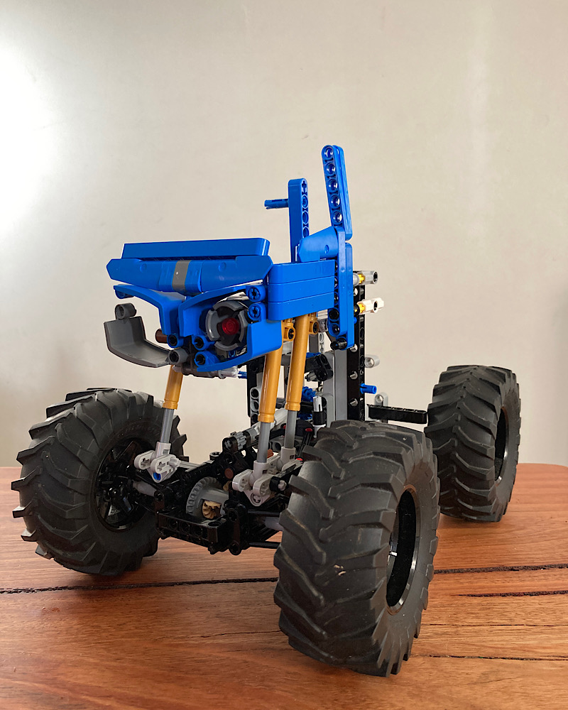

Yesterday I started working on a minimal ‘internal’ structure chassis that I can later hang a faux tube frame (of axles) and body work on (hopefully)
how it sits at the moment reminds me of a typical monster truck so happy so far and happy to be building again.

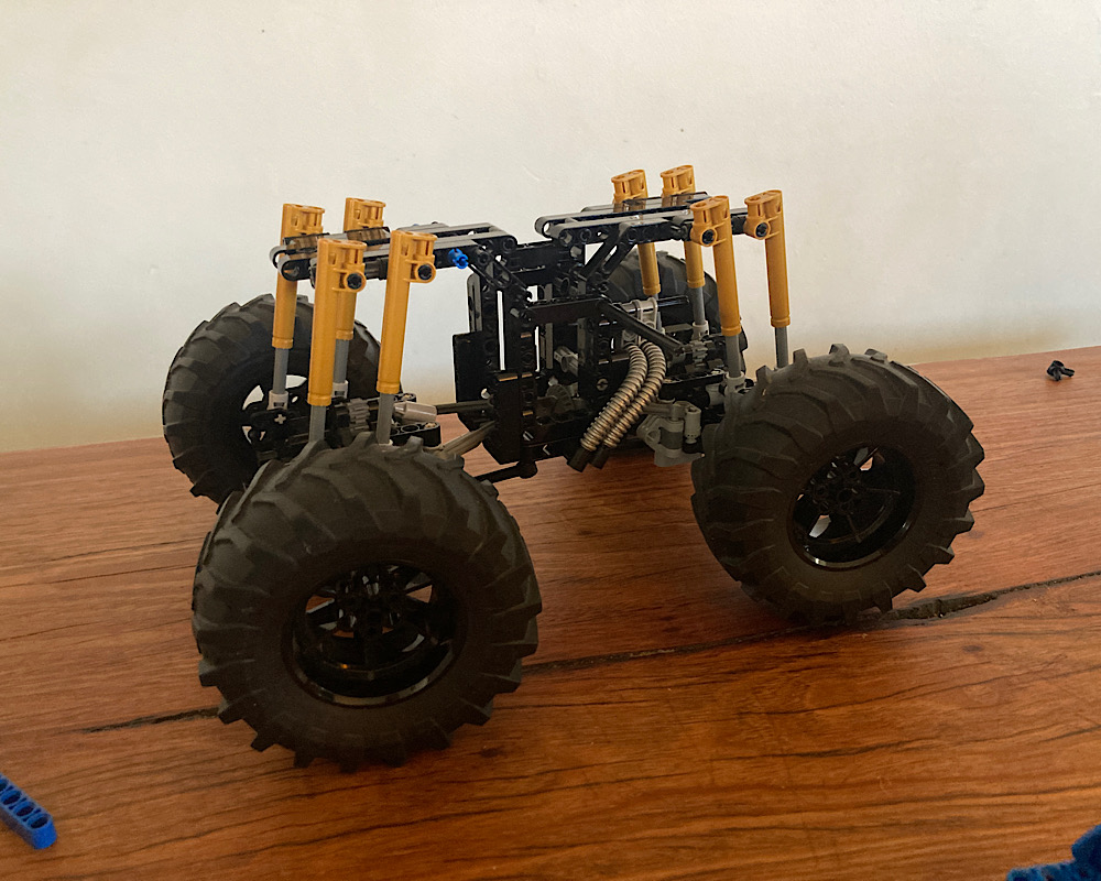

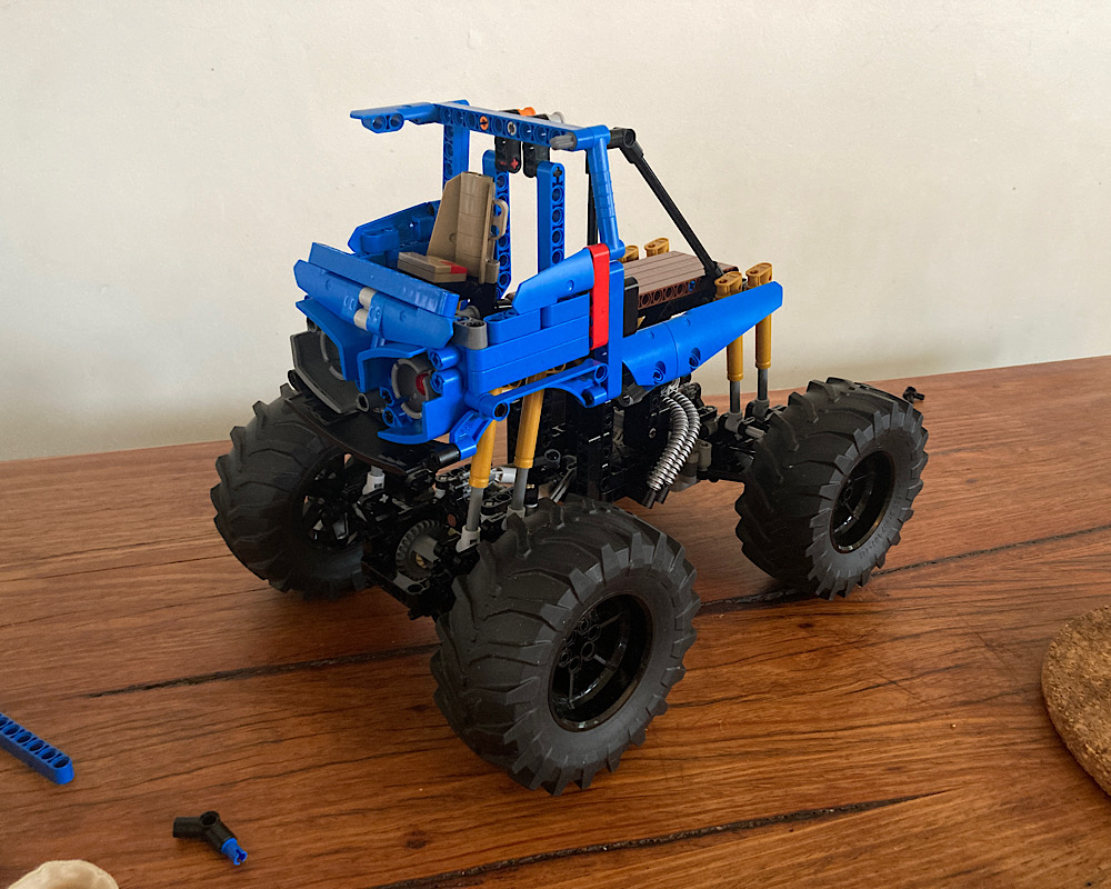

Chassis is looking a bit rough and colourful at the moment as I build the mock-up because I shortened the wheelbase by using 6L links instead of 9L as I now have settled on a theme for the truck which is a Kei style small truck with ‘Skeletor’ subtle tones (title change squeezes in kei in the name just because :laugh:)
The truck body itself should end up being roughly 1:15 to suit the tyres which are roughly 1:15 (going by typical monster truck measurements) hopefully removable from the chassis.

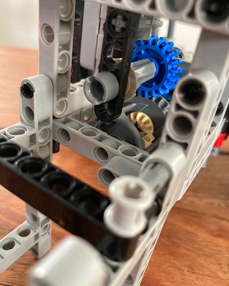

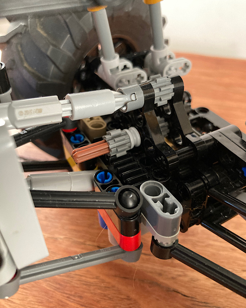

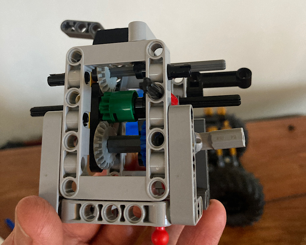

Steering was harder to implement so I have got the steering through the drive gear but have had to lift the input on the axles to make it work with the long travel suspension (8T missing at the moment).
Not sure this blue 20T gear can be legally driven like this? Will swap to the other diff with newer red gear if so but don’t want to use it because its red and will stand out
Some subtle 'Skeletor' vibes (hopefully) with the headlights. Aiming for a purple cargo tray on the back etc.
Shorter wheelbase
