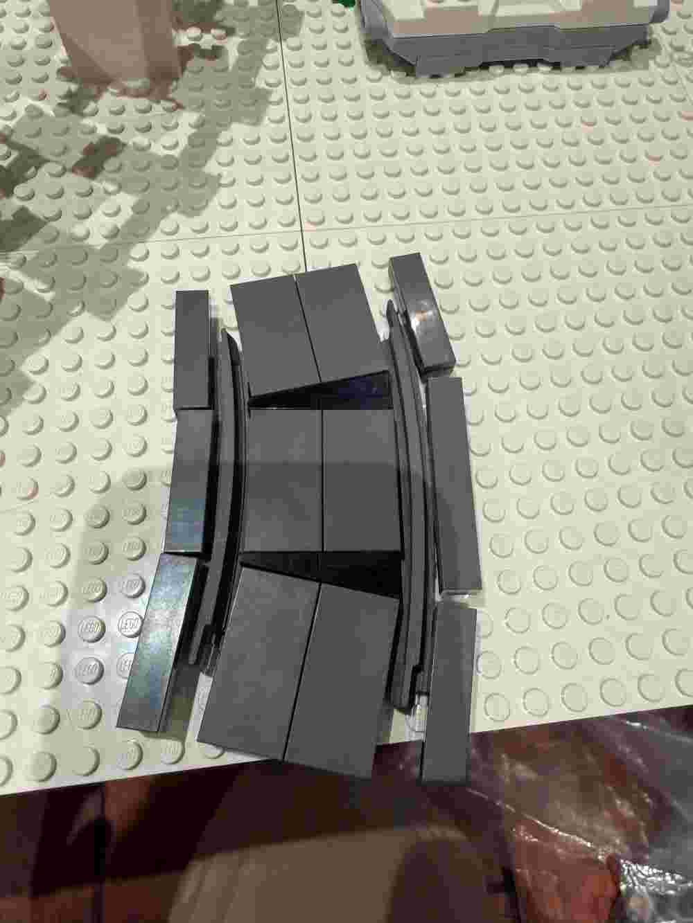

Mafortune Posted December 1, 2025 Posted December 1, 2025 I apologize for asking a question which i assume has been answered here before, but I am not able to find it.. Due to lack of space, i had to settle for trixbrix R24 curves for the tram in my city. Further, again due to lack of space, i need to build an eight studs wide road for cars within the tram track. I have not been able to do this in a way which makes it functionable for both a motorized tram (the powered up motor) and the cars in the corners, while it works very well on the straights. Any suggestions? Any help is much appreciated! Quote

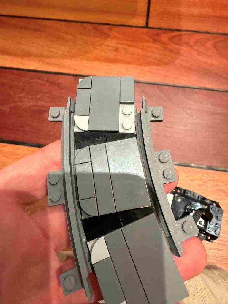

Mafortune Posted December 2, 2025 Author Posted December 2, 2025 Thank you all for your responses. As there seem to be no perfect solution (except for possibly the very complicated one shared by davidzq), I'll share how I tried to make it work. I started by calculating distances and angles and I was very hopeful that a simple solution containing only 4x4's and 5654's should work. And it actually looked quite promising: However, it turns out that it was too tight on the outside corner of every 4x4, causing the tram to derail. Consequently, I found a workoround which is slightly worse to look at, but still acceptable: Unfortunately, I also discovered that 5654 does not come in dark grey, which is kind of strange. However, this is the best solution I currently have, but I am definitely open to other ideas. Is there any way to make the tram wheels to require less space? Maybe by increasing the space between them? Will probably increase the chances of derailing again though.. Quote
L-Gauger Posted December 2, 2025 Posted December 2, 2025 3 hours ago, Mafortune said: Unfortunately, I also discovered that 5654 does not come in dark grey, which is kind of strange. However, this is the best solution I currently have, but I am definitely open to other ideas. Would 2 of parts 61409 or 5404 work to replace the 5654? It appears these smaller slopes are the same angle as part 5654, and both the 61409 and 5404 come in Dark Bluish Gray. Quote
davidzq Posted December 3, 2025 Posted December 3, 2025 68869 might work well for this, though it's only available in light grey. Quote
