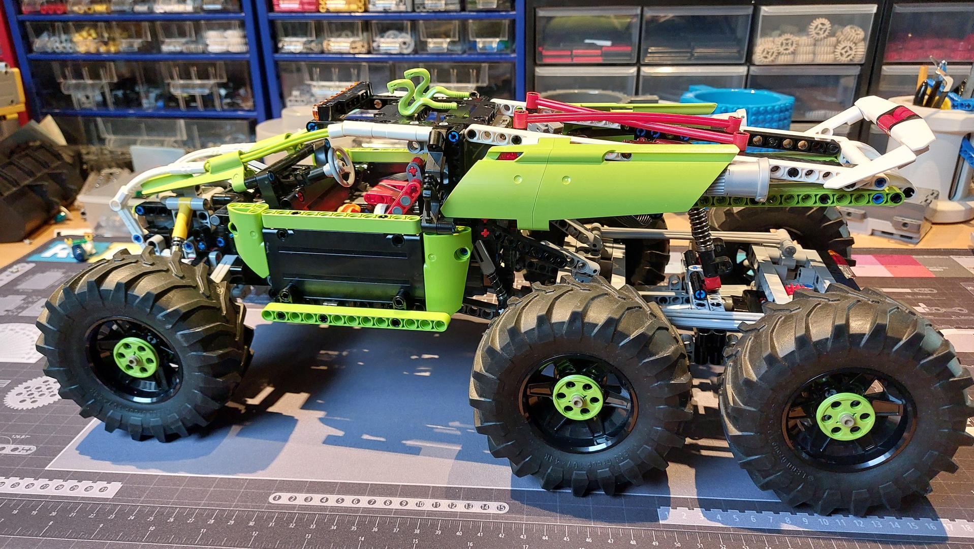

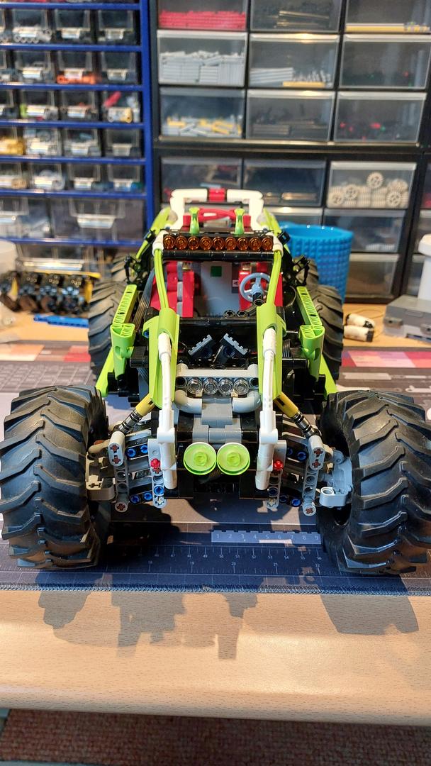

vliet Posted December 9, 2025 Posted December 9, 2025 Some time later the pictures where the right size. I am almost done building, not completely happy with the colours, but that is not difficult to change. Quote

Kamil Posted December 12, 2025 Author Posted December 12, 2025 Really cool, I like it. A spaceship on the road. Good job Quote

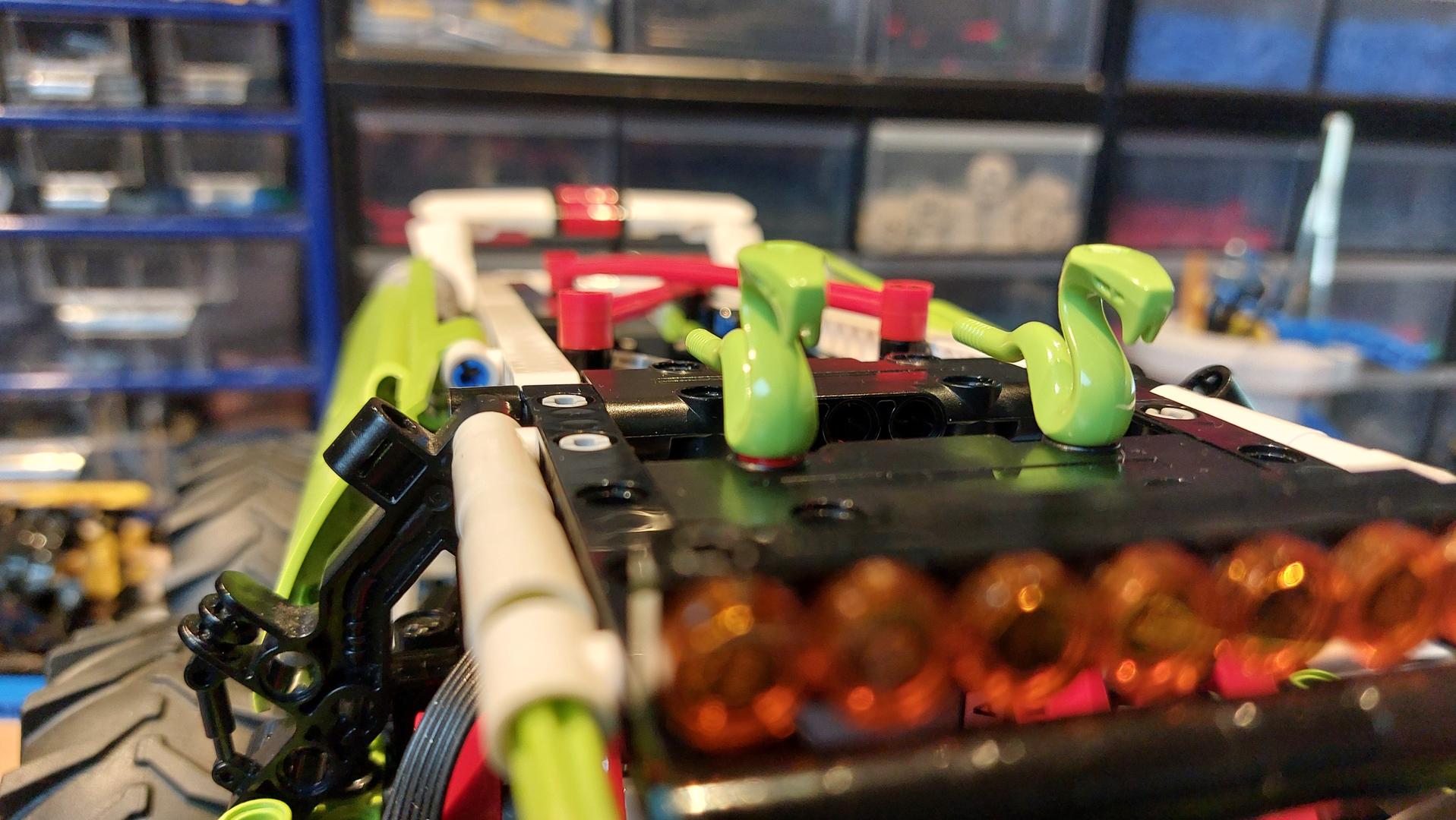

gyenesvi Posted December 12, 2025 Posted December 12, 2025 Looks massive indeed, cool color scheme! I like those snakes on the top :) What is that Switch controller for? I haven't yet used it I think. Quote
