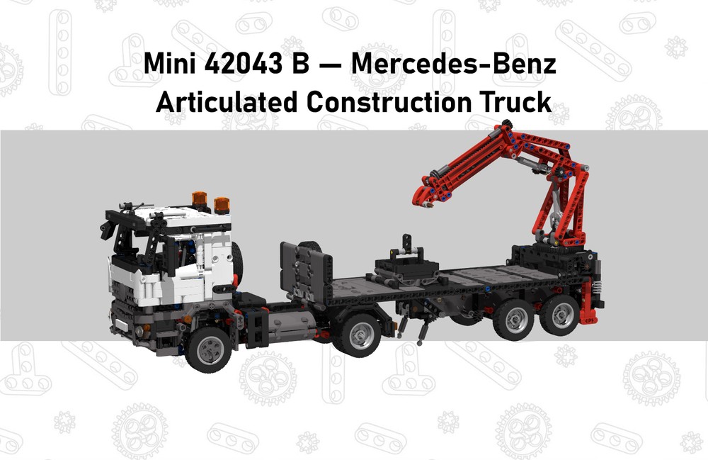

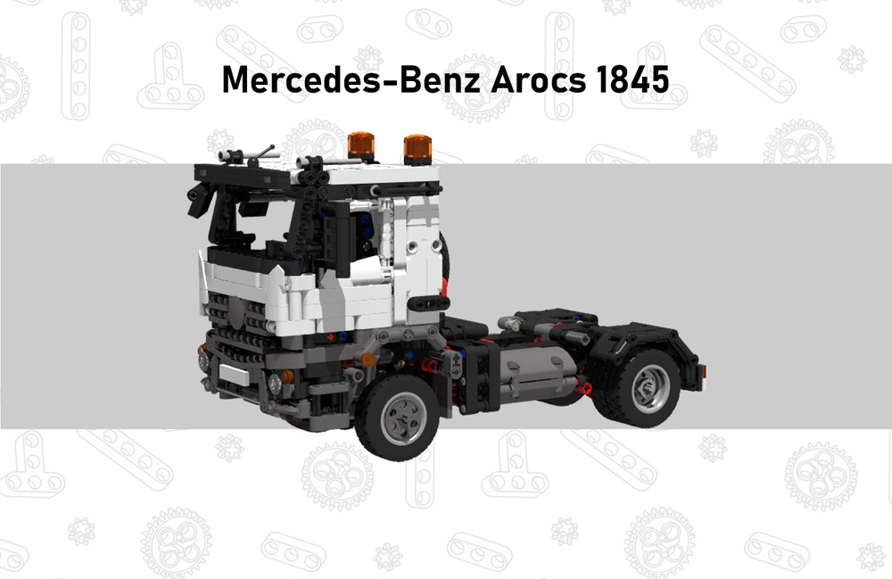

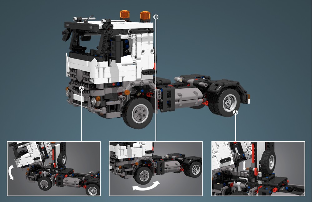

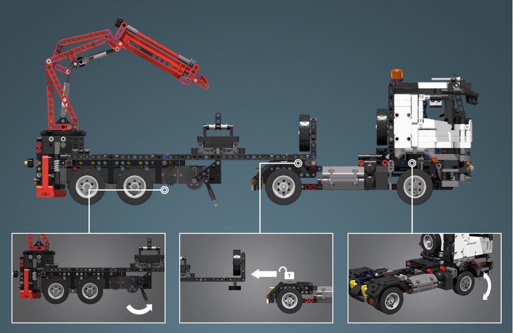

Per some requests, I made the alternate model a separate MOC. Even though this is an alternate model, it was designed with the same dedication as the main model.
1000x800.jpg?1767371943.4202402

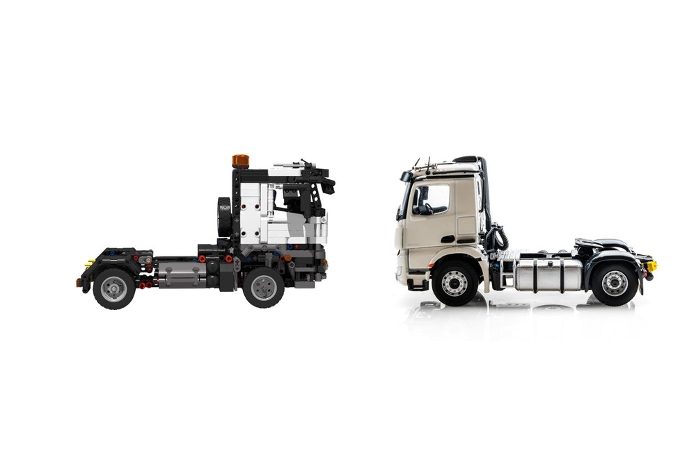

According to the sticker, the tractor truck is based on the Mercedes-Benz Arocs 1845. It's a rather unusual tractor truck because its length is larger than its height even though it's a 4 wheeler.
truck-tractor-Mercedes-Benz-Arocs-1845-K
The original tractor truck doesn't really capture the proportion because the suspension makes the body sit higher. Also the tractor truck houses the battery box but the motor is in the trailer, the body must be shortened so that the cable can reach the battery box.
42043_alt4.jpg?fit=crop&quality=80&width
Because my model doesn't have to accomodate such constraints, I was able to make the tractor truck more accurately.
1000x649p.jpg?1767417264.1280677
To ensure the accurate look, I removed the suspension from the rear axle, so only the front has spring loaded suspensions.
1000x649p.jpg?1767372541.8408005

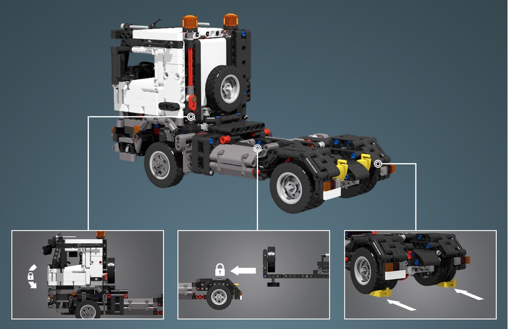

My favorite part is the rear, where I used the curved quarter liftarms to mimick the guides for the trailer hitch and manage to find a place to put the wheel chocks. I also added a ladder and a platform behind the cabin. In the original B model the rear wheel is placed under the fuel tank, but there's no space for that in this mini replica, so I put it behind the cabin instead.
20366210-05.jpg?v=1761268573
1000x649p.jpg?1767372541.4887931

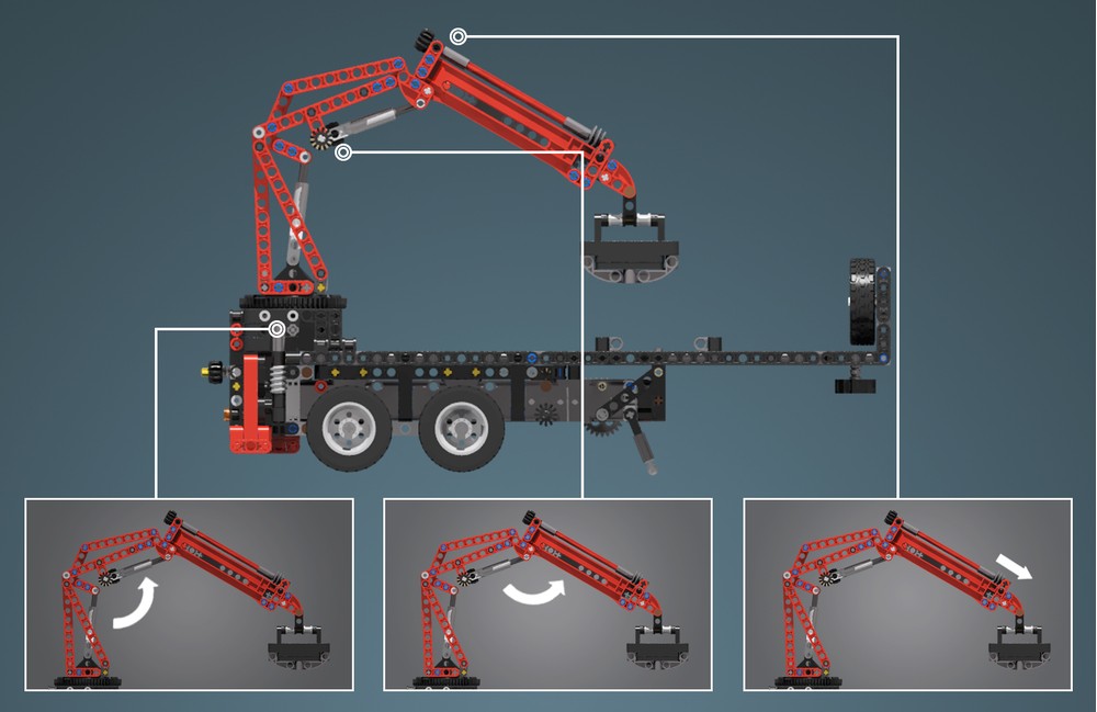

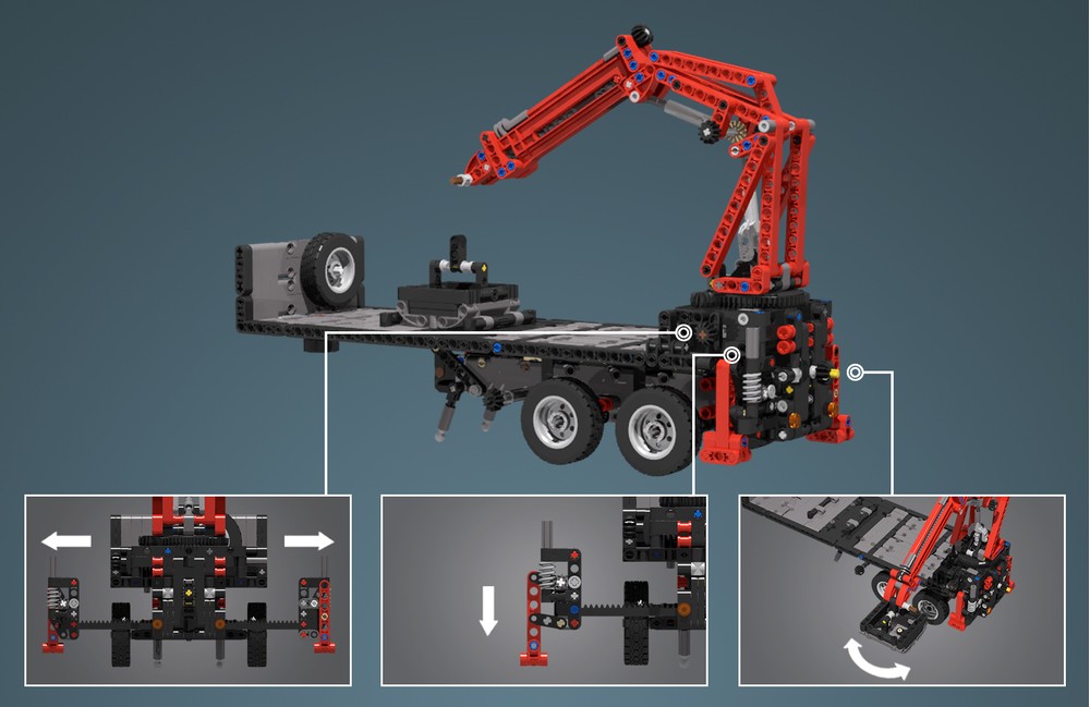

The rest is just taken from the main model, no shame on that :grin:
