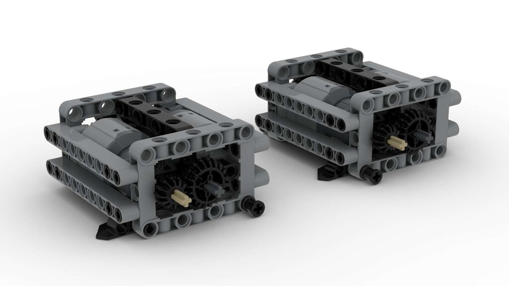

domik Posted March 12 Posted March 12 Hello. Some time ago I designed this 4WD "engine" as I call it. I basically got tired of the front steering wheels being just pushed around by rear motors in my RC cars. But I didn't really know how to build such a model that would use this engine, and didn't have as much bricks as I've got now, so I abandoned this idea. But now I'm coming back to it, and I started to wonder if it's even possible to make a car that has pretty good capabilities off-road with just two PF L Motors, and one Buwizz. So I wanted to ask if someone has an opinion on this. There are two outputs on 2 sides, as you can see in this image. Have a nice day! Quote
HorcikDesigns Posted March 12 Posted March 12 Depends on drivetrain between this motor pack (I would not call it engine) and wheels, desired speed and size of the vehicle and wheels you would like to use. But with the buggy tires (also from F150 Raptor set) you can build quite capable and fast offroader, if the vehicle is as simple and light as possible and has efficient drivetrain. Quote
Aurorasaurus Posted March 12 Posted March 12 5 hours ago, domik said: Hello. Some time ago I designed this 4WD "engine" as I call it. I basically got tired of the front steering wheels being just pushed around by rear motors in my RC cars. But I didn't really know how to build such a model that would use this engine, and didn't have as much bricks as I've got now, so I abandoned this idea. But now I'm coming back to it, and I started to wonder if it's even possible to make a car that has pretty good capabilities off-road with just two PF L Motors, and one Buwizz. So I wanted to ask if someone has an opinion on this. There are two outputs on 2 sides, as you can see in this image. Have a nice day! Are the two outputs connected? Why not have the motors hard coupled together, and an axle going through the middle of them? As for capabilities offroad, it really depends. Some people can make extraordinary things with 2 L motors (Attika, look at his pickup trucks on yt) and some people opt for much more power. If you want a decent balance of speed and power, I'm sure it can be achieved with 2 L motors, just keep the weight down. Also, I think you might find Sariel's book on lego technic useful, as a good way to get all the basic knowledge you need coming into the hobby. Its outdated, we have better pieces now, but the principles are the same. Quote
gyenesvi Posted March 13 Posted March 13 Here's my attempt of such a car: And also I built many others with just 2 (PU) L motors that are not too fast but climb well off-road, especially when powered by a Buwizz instead of Technic hub: https://rebrickable.com/users/gyenesvi/mocs/ Quote
domik Posted March 13 Author Posted March 13 21 hours ago, Aurorasaurus said: Are the two outputs connected? Why not have the motors hard coupled together, and an axle going through the middle of them? As for capabilities offroad, it really depends. Some people can make extraordinary things with 2 L motors (Attika, look at his pickup trucks on yt) and some people opt for much more power. If you want a decent balance of speed and power, I'm sure it can be achieved with 2 L motors, just keep the weight down. Also, I think you might find Sariel's book on lego technic useful, as a good way to get all the basic knowledge you need coming into the hobby. Its outdated, we have better pieces now, but the principles are the same. I haven't thought about coupling these motors together in this way, but that is brilliant! Then there would be power of two L Motors in coming to each wheel..? This sounds impossible tho.. And I did hear about and thought about getting Sariel's book, but knowing me, I probably will learn more with experimenting. Quote
Aurorasaurus Posted March 13 Posted March 13 18 minutes ago, domik said: I haven't thought about coupling these motors together in this way, but that is brilliant! Then there would be power of two L Motors in coming to each wheel..? This sounds impossible tho.. And I did hear about and thought about getting Sariel's book, but knowing me, I probably will learn more with experimenting. Thats right, if you couple the two, the rpm should be about the same as just 1, but the torque is doubled. As for sariels book, you may learn more by just experimenting... if you know what experiments to do! I'd highly recommend getting it, it'll save you a lot of time. Quote
