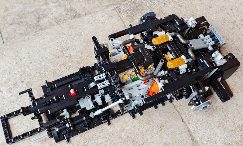

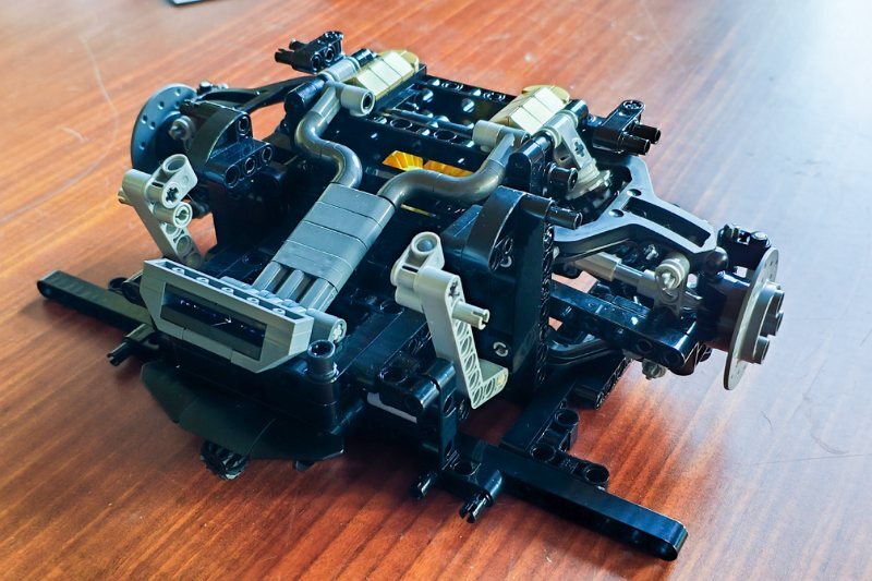

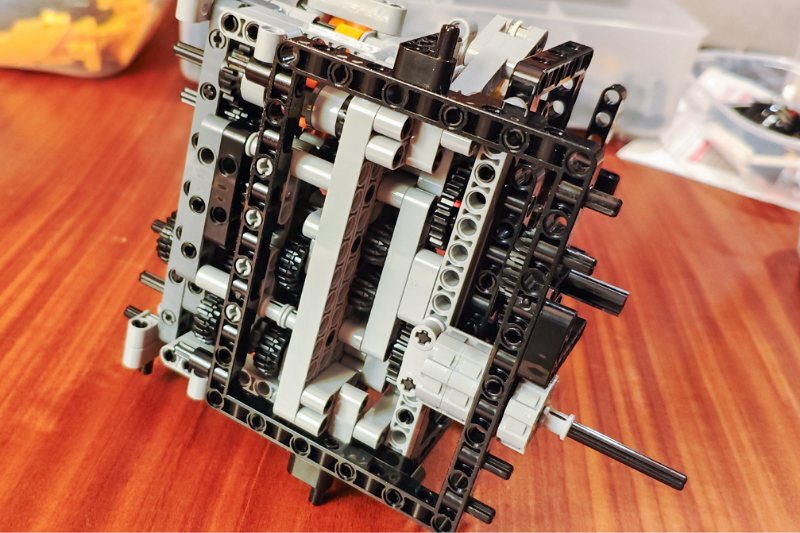

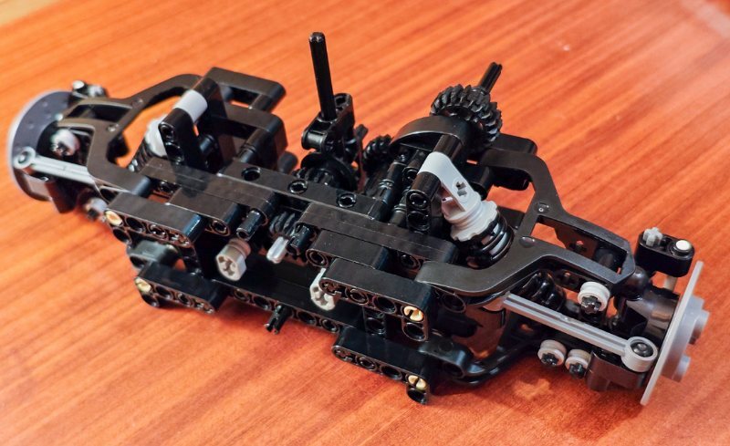

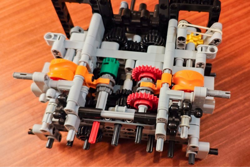

jb70 Posted December 18, 2025 Author Posted December 18, 2025 I have released an update to Pimp up my McLaren with release v1.1. These are the new improvements: removing clutch gear in main drive shaft (steps 31, 91) gearing up main drive shaft higher revolution / reduced torque (steps 1, 31, 92, 173) reinforced gearbox less friction, better bearings (steps 90, 92, 99, 107) DNR gearbox => prevent 4L axle shift out when joining front and back modules (step 170) additional gear box blocker at HOG gear box switch for more precise shifting (steps 270-273) improved building instructions more easy to use higher level of modularity in submodels only 4 main parts (back, front, left, right) for chassis, easy to connect (steps 284-285, 330-331, 373-374) only 2 main parts (right, left) for roof (steps 420, 429) allows quicker disassembly and reassembly of unchanged submodels recolouring several parts for a cleaner look A closer look to the new drive train: The new modular design with only 4 main submodels for the chassis: After mounting these 4 submodels you are able to do a test drive: Have fun pimping up your McLaren! Quote

jb70 Posted December 19, 2025 Author Posted December 19, 2025 12 hours ago, zonoskar said: I hope v1.1 didn't speed up shaft speeds even more from the v1.0 build, it's already too fast in my model, I barely can use first gear. No worry! I had the same experience with my v1.0 build after having the car on shelf for a year. The clutch gear was often cracking in 1st gear. That was the motivation for my redesign with v1.1. Now the car runs very smooth in 1st gear. I kept the total gear ratio constant from wheel to engine. Only the main drive shaft speeds up a little to reduce torque on the U-Joints. Quote
