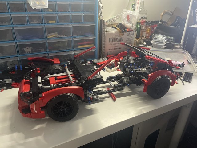

dantheman12 Posted February 2, 2025 Author Posted February 2, 2025 (edited) Some long awaited progress. Partly due to my Pick-a-Brick order taking nearly 3 months. Started working on the front body work, finally finished the front suspension with my new parts, and did a lot more work on the rear end. Quite proud of the rear suspension, I managed to fit the LSD in, and it's as close as I think I can get to the real thing with Lego parts, and it's more than sturdy enough for me. The sway bar doesn't really work, the axle just twists, but I dont see any better way to do it without it taking up way too much space. Edited February 5, 2025 by dantheman12 embedded pictures Quote
Aurorasaurus Posted February 7, 2025 Posted February 7, 2025 That looks great, I feel like you captured the front of the car very well. It feels fast, just from the photo. Quote
