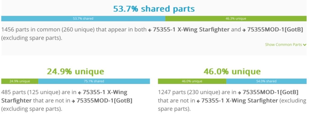

75335 Original vs 75355MOD-GotB (excl. minifigs):
1949pcs vs. 2711 pcs
1.80kgs vs. 2.0 kgs
563x443x118mm vs 576x495x112mm (without stand)

Assuming you had a 75355 X-Wing lying around, how many new parts would you need to buy to build this?
2 hours ago, Krazeh said:
Great work!
Thanks! Let me indulge you on this with the following screen shot from rebrickable. The majority of the parts are readily available as we’ve put in a great effort to make it easy for everyone to upgrade their 75355 X-wing.
You can download the parts list together with the manual to see if you like it.
Edited by Rilted
