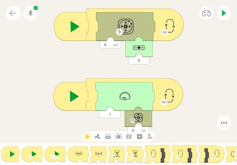

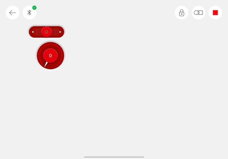

So, I'm trying to make a simple controller here.  The top button works, but getting the speed output thing to display isn't.
I'm guessing that the train motors can't report their speed?

All the blocks are explained here:
https://www.lego.com/en-us/service/help/Power_Functions/LEGO-Powered-Up-programming-blocks-kA06N000000g04eSAA
Expand
No, they don't.
Just replace the motor block in the lower program with the green "Slider 0" symbol, like you use it in the upper program.
