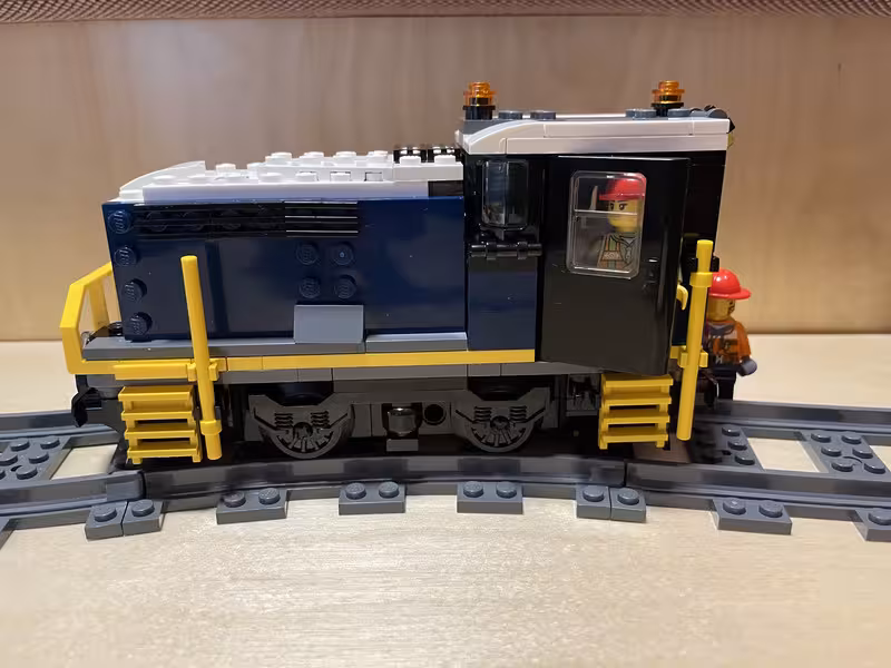

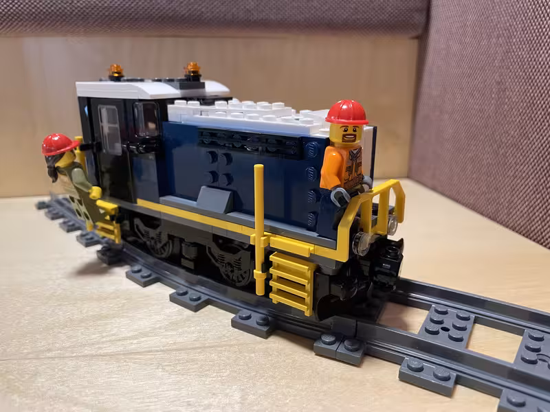

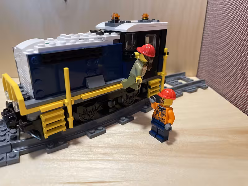

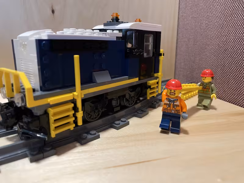

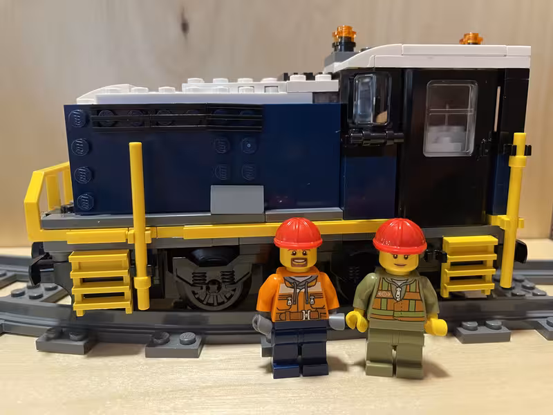

faph Posted April 9, 2024 Author Posted April 9, 2024 (edited) I managed to actually build the blue version: Still waiting for some 1x8 yellow plates with door rail to replace the yellow stripes on the side. It runs pretty well with Pybricks with nice and slow accelerations and braking! So much more fun compared with the start/stop of the Lego train motors. I will see if I can get a video going as well. Edited April 9, 2024 by faph Quote
Feuer Zug Posted April 9, 2024 Posted April 9, 2024 Looks great. Nice work covering up the battery box/Pybricks controller. Quote
CastleRail Posted April 10, 2024 Posted April 10, 2024 17 hours ago, faph said: Still waiting for some 1x8 yellow plates with door rail to replace the yellow stripes on the side. Posted them yesterday morning, they should be with you soon They come courtesy of a #4564 that wasn't intact enough to consider rebuilding Is the cab completely clear or is the motor hiding inside it? If clear then that is seriously compact, either way still a cracking build :-) Quote
faph Posted April 10, 2024 Author Posted April 10, 2024 @CastleRail Train-to-train recycling, excellent! Motor does take up most of the cab, roughly up to window level. However, the cable takes up most of the space above, so you still cannot see through from one side to the other. Quote
faph Posted April 12, 2024 Author Posted April 12, 2024 @CastleRail Toe-rail installed and tested! Quote
JopieK Posted April 14, 2024 Posted April 14, 2024 Very nice. For shunters the Powered Up brick is way too large. I was trying to fit one in a retro 7760 but so far I'm not satisfied. Your solution is at least already better by replacing the train motor with this one. Quote
faph Posted April 14, 2024 Author Posted April 14, 2024 For avoidance of doubt, this shunter fits both a Powered Up Hub and a Powered Up medium motor. Quote

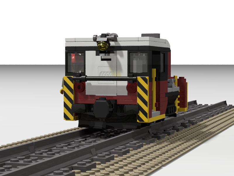

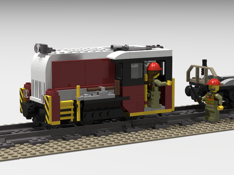

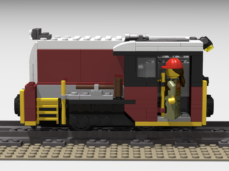

faph Posted October 27, 2024 Author Posted October 27, 2024 (edited) @JHS_NL Since you asked so kindly: let me introduce shunter "Bulldog": Staff were complaining the climb up to the cabin was too high! And forward vision wasn't great either... This shunter is heavily inspired by some Köf builds including this one: https://rebrickable.com/mocs/MOC-68383/Dennis Tomsen/lego-gmbh-spielwaren-kof/#details by Dennis Tomsen. I will have to work out whether this 8 wide engine works well enough for me. Everything else we have is 6 wide (excluding hand rails etc). This engine is 2 studs shorter compared to previous ones. Edited October 27, 2024 by faph Quote

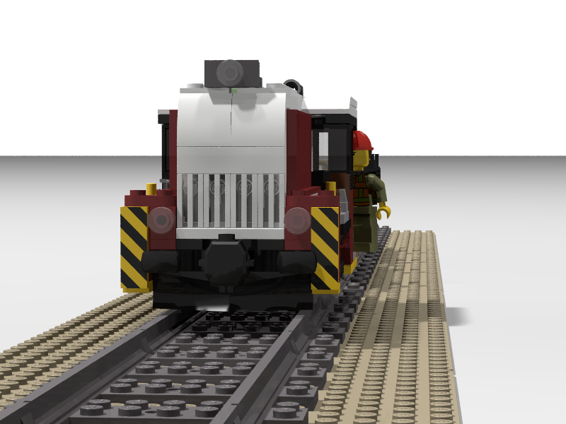

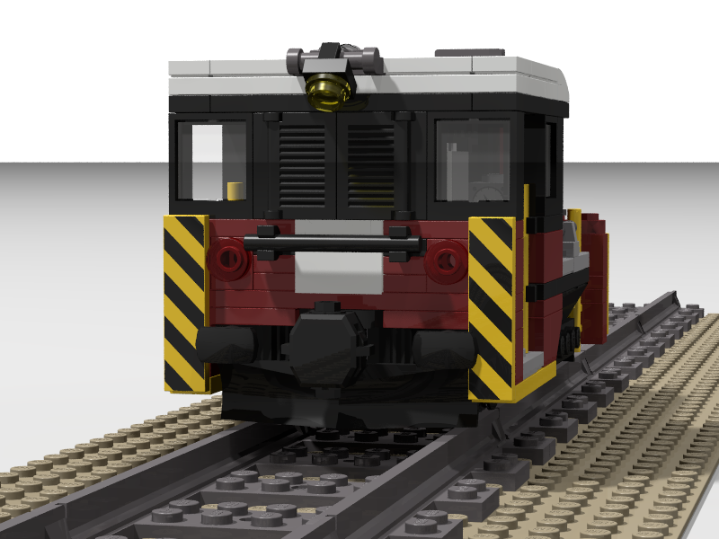

faph Posted October 27, 2024 Author Posted October 27, 2024 The rear of the engine led to the nickname "Bulldog". With respect to all dogs out there: there are more flattering looks around (both for dogs and engines)... Quote
