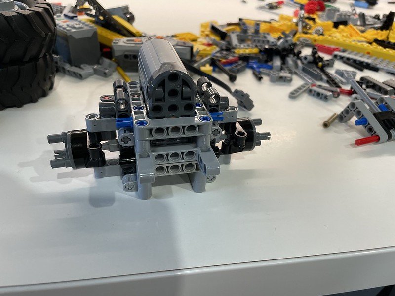

Pufarine Posted December 17, 2023 Posted December 17, 2023 On 12/10/2023 at 11:20 AM, 1gor said: I'm just looking how to make 2 studs more narrow steering axle with planetary hubs... This one is a bit wobly... This is my take for a front axle, for a small terain vehicle. Sorry for the offtopic. Quote
1gor Posted December 17, 2023 Posted December 17, 2023 1 hour ago, Pufarine said: This is my take for a front axle, for a small terain vehicle. Sorry for the offtopic. Thanks for help, but I'm looking how to use reduction hubs Quote
