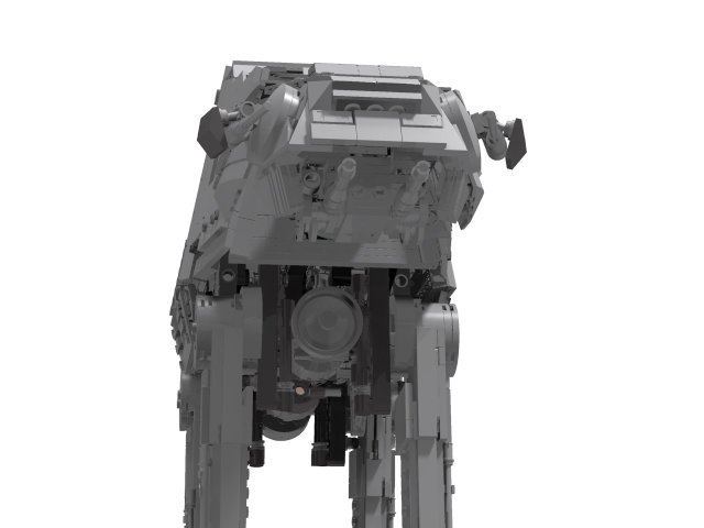

Thanks, though i’m afraid from what I can tell the gait is the same as the other lego motorised AT-AT. But I have news. So I ran into a problem where the positions of the feet were not at an angle such that all feet that were supposed to be on the ground at a point in time were not flush. I have since changed that, the mechanism remains similar otherwise. I believe I am on the last stretch though to getting a moving machine. I intend to use the head turning left and right for balance too so that mechanism will have to be made. Progress though, is happening.
53698431559_80919d69b2_w_d.jpgIt is great to finally be adding bodywork where the shape and design is somewhat a good compromise between accurate and possible (what with the gears and movement being quite limiting). Admittedly I did not work very much on it this weekend as I was working on another non lego project. So this much progress in such a short time is good.
14 hours ago, Carsten Svendsen said:
We still haven't seen it walk though... Does it actually function? The bodywork won't matter now, if you have to rebuild it later.
It breaks up the monotony of redesigning the system each time I run into an obstacle. But also as the key problems have been fixed (the feet that are not raised being flush with each other on the floor, the strength of the springs to hold up the weight) it (the mechanism) is essentially finished, in the pic below you can see it was nearly there before I had to fix the aforementioned issues. I reckon i’ll get it walking next weekend.

Ok so having worked on it some more I am being defeated by balance. Naturally it’s a little wobbly and when a leg lifts up it has a tendency to lean towards that direction. I’ve attempted to counteract that by experimenting with the head placement and so far landed on this angle as the way to support a lifted front leg. I was hoping to add a head movement mechanism which alternates the way the head is facing to shift the weight when one side has a leg lifted, unfortunately this angle is not ideal nor realistic. Note this problem is only a problem with either one of the front legs raised. A less extreme angle is enough for the back legs.
the head
The feet position.
IMG_5843
Balance is tricky on such a spindly leg vehicle. Can you use an internal (boat)weight that moves left and right for balance? That will sacrifice some internal space of course, not sure if that is compromise you are willing to make.
I would love to see this thing walk :wub:
I’ll order one (or a few) and see, if it turns out not to work I may just consider it an acceptable “loss” for the project. After all it still stands up and likely walks (once motors are in place) it just leans.
Edited by BrickBear
I have succeeded in reducing the balancing issues by simply placing a 2x1 plate with rail underneath the innermost toe of each leg, this offsets the legs lean somewhat but it’s still precarious. Of course this means that the feet aren’t completely flat on the ground, it’s a cheap and easy fix, might have to place rubber pieces in the feet too as they tend to slip on smooth ground.
I’ve also been working on the neck bending so it bends in two places, this is nearly finished and has significantly increased the rigidity of the head and assists with the balance.
All that remains is to install the motors and place on the bodywork then hopefully it will work. The springs appear to be able to support the weight, let’s hope they can support some more.

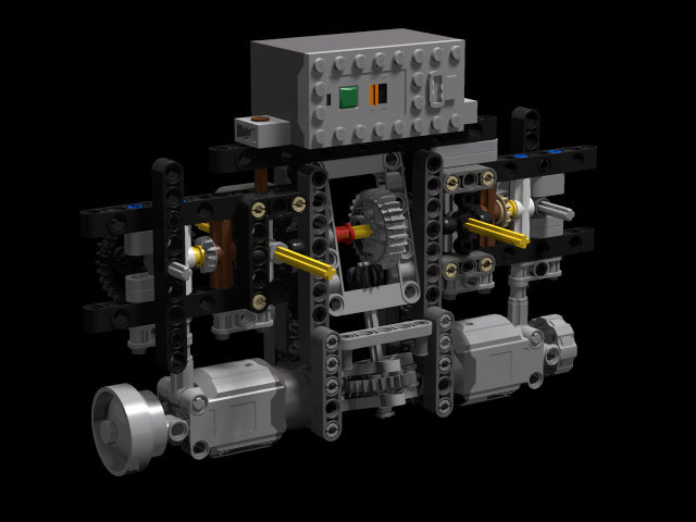

Man. I have been itching to get in on this thread. The registration verification takes a long time for this site. I also have been trying to create a Lego AT-AT that walks one leg at a time for about 4 years. I have had varying degrees of success. This is my best effort to date. I'm intrigued by your use of gearing, quite advanced. I too started with the legs and worked inward, which ultimately was not the best direction in my case. I quickly realized that the chassis supplying the power was just as critical. Everything in my design has hinged on stability. Just as important as the motion of the lifting leg, is the rigidity of the non-lifting legs. This balance of letting components be free to move, then locking them down, has been incredibly challenging. I ended up going with more of a cam-based design than a gear-based design. Lego gears just have too much lash. When the legs aren't moving, they must be solid, and the gearing just allows too much movement. But I'm really excited to see if you can figure out a way to make it work. I feel like I'm so close, but the final issues are difficult to solve.

Glad to hear you're still keeping the project alive. As for the lower weight distribution, early on I decided to sling two Power Functions large motors underneath, at the bottom of the chassis, to both get the weightiest part as low as possible and also replicate the look of the film version engines. I also went with the small size battery box with super light lithium AAA batteries since in my design, that box ends up at the top inside the body. I've been tinkering with some new cam designs, but haven't had much luck. I'm going to try reverting to the build I had in the earlier post's video and see if I can refine from there. I have a few new ideas.
 chassis_sample.jpg.5809345002d963faad86673ef4c74bc6.jpglow_motors.jpg.8ec67c0cd7db5ff372a77ffc10bc8701.jpg

Mmm, I might redesign the main chassis. It’s beautifully compact but yes, it probably needs an adjustment to account for the weight.
Here are a couple more ideas that may help your cause. I too have the same issues with balance/leaning and sought to get some compensation in the feet and legs. I came up with a way of mating the external legs to their internal connecting rods with a small ball/bar piece wedged in between a stud-pin and round 1x1 plate to create a bit of negative camber (Image 1). I also utilized the ankle strut feature seen in the film models to get more negative camber from the leg to the foot. I made the struts just a bit too long for the distance so they push the feet out a bit crooked (Image 2). Also note that the feet/ankles on my model have very limited movement, probably less than 10 degrees. I found this essential to keep the model from pitching forward or backward and falling on its face or butt if the feet slid. Finally, you can see in image 3 that the model is quite rigid at all points during its cycle. If I hold it sideways, the legs barely deflect at all. My early versions all started out pretty loose and I had to really lock things down. Of course, we are taking somewhat different approaches, which I find really intriguing, so these features may not be as necessary in your design. There was a post earlier in this thread that suggested a cam system that is very close to the concept I'm using (although I had already tried and failed with the parts he suggested and used a different method of creating cams.)
