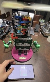

dustblue Posted September 17, 2023 Posted September 17, 2023 Hey guys, recently I've been testing lego technic system power up limits, because I plan to make a 8 buggy motor drive trail truck, but I need to know if it is practical first. So yesterday I couple 4 buggy motors together, to drive my 4 sequential gearbox, to power a 5 blade propeller. I use this test setup because the power output and input is coupled very well, the output is powerful enough to suck in all the power from the input(you can see this from the currents the buggy motors draw). Photos: ok this forum can only upload 30kb photos, maybe it's designed from 1999. Use this: https://drive.google.com/drive/folders/1zjbJZIW18TFNwHwXXQR7grqEwignfjVb?usp=drive_link This 4 speed sequential gear box gear ratio: 1.75; 1.2; 0.833; 0.57 So it's around the buggy motors' rpm, not much deviation from it. This gearbox is very effective, the propeller is setup to make down force, in gear 1 only 75g down force, gear 2 150g, gear 3 230g, and gear 4 would be higher but the orange clutch can not keep the driving ring in position. So these new gearbox parts are not powerful enough to handle this 4 buggy motor input, now this is the first problem, which should be easy to overcome: just don't use these new shifting gear parts. The second problem is much more serious, after just a couple minutes testing, mostly in gear 3, which means the output rpm is 1.2* buggy motor native rpm. In this senerio the beam that holds the output carbon axle melted!!! I know the rpm is not the problem, the actual problem is the torque*rpm which is power output. In this gearbox design I can not make a symmetrical design on the output axle because I only have one set of the new parts from Lego 42159 so only 1 24 gear with driving ring input. However even if I can make a symmetrical design, it only eliminates output axle load problem, for the planet gear axles there would be still significant loads, in half, and still facing the melting beam problem. Someone might thinks using lower rpm like L motors or xL motors, however there are much more hard to conquer pronblems in those setups, which is torque. I tested, in native output, xL motor torque is 2.5 times buggy motor, 3 xL motors coupled tegother would destroy carbon axle! 10-15 buggy motors coupled tegother can also do it. For lego plastic axles it would be much more easier. 3 buggy motors coupled could destroy 8 teeth gear! 5 buggy motors can destroy plastic lego axles. So you see using buggy motors is to avoid the high torque situation, and leave it to the wheels( I use custom designed planet gear reduction on wheels, and wheel locks to prevent wheels comming off which is the no.1 problem of lego technic system). And now, even buggy motors have limits.I have silicone oil and I would lubricate the parts when remembered. but is there anything else you can do to higher the system up limits? Quote
dustblue Posted September 17, 2023 Author Posted September 17, 2023 I myself used direct drive a lot, like 1 buggy to drive 1 wheel, or 2 L motors to drive 1 wheel. That way can distribute system load, and get diffrentials/diffrential locks out of the car. However, it also significantly increased the unsprunged mass, also make it hard to use gearboxes, make the vehicle less real and hence less fun. Quote
dustblue Posted September 17, 2023 Author Posted September 17, 2023 (edited) detailed analysis photo uploaded, the one with many colorful arrows. red arrow is input torque force direction, green is force on output axle, yellow circle is pivot point, purple arrow is the effect of green arrow axle force after the pivot, and it's the melting direction of the beam(the force is max on this direction hence friction max). the lesson learned: you must use symmetrical output in high power situation, or try something to elimanate unwanted force on the axle. Edited September 17, 2023 by dustblue Quote
