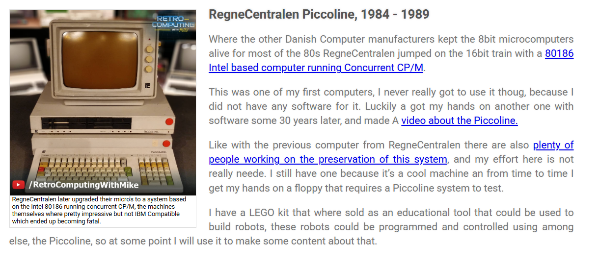

amine Posted Tuesday at 09:48 AM Posted Tuesday at 09:48 AM (edited) https://www.retrocomputing.dk/about we need to get in touch with him Edited Tuesday at 10:01 AM by amine Quote
Toastie Posted Tuesday at 02:59 PM Author Posted Tuesday at 02:59 PM @amine - I agree! Did you contact him? Totally unrelated - do any of you guys follow the YT channel of Dave Plummer (Dave's Garage)? This is a really cool channel, he was with Microsoft back in the days. His tutorials and other videos are just mind-blowing. (OK, they blow my mind ...) This is for the elderly in this thread: Ir is as here were 1:1 describing my early computer years in Northern Germany (I had to download the transcript of this video - it is too good to just see or hear it. I reformatted it by hand and not ChatGPT ): He talks a lot about BASIC, @evank! Best Thorsten Quote
amine Posted Tuesday at 04:53 PM Posted Tuesday at 04:53 PM 1 hour ago, Toastie said: @amine - I agree! Did you contact him? Totally unrelated - do any of you guys follow the YT channel of Dave Plummer (Dave's Garage)? This is a really cool channel, he was with Microsoft back in the days. His tutorials and other videos are just mind-blowing. (OK, they blow my mind ...) This is for the elderly in this thread: Ir is as here were 1:1 describing my early computer years in Northern Germany (I had to download the transcript of this video - it is too good to just see or hear it. I reformatted it by hand and not ChatGPT ): He talks a lot about BASIC, @evank! Best Thorsten Yes he told me is out of the Lego hobby and want to leave all his stuff including a C64 cable to somenone serious . Quote
evank Posted Tuesday at 05:44 PM Posted Tuesday at 05:44 PM If he was in the US then I'd be all over it .... but he's in Europe and I already have the original Lego Commodore cable. :) @Toastie I think you should rescue that collection. Quote
Toastie Posted Tuesday at 05:47 PM Author Posted Tuesday at 05:47 PM 2 minutes ago, evank said: I think you should rescue that collection. Well I believe @amine is already all over it, right? He is also in Europe ... Best Thorsten Quote
amine Posted Tuesday at 05:59 PM Posted Tuesday at 05:59 PM (edited) 14 minutes ago, Toastie said: Well I believe @amine is already all over it, right? He is also in Europe ... Best Thorsten When he said "Serious" it is an european way to estimate the number of zeros, and there are three of them.But go ahead I dont have C64 anyway. Edited Tuesday at 06:02 PM by amine Quote
