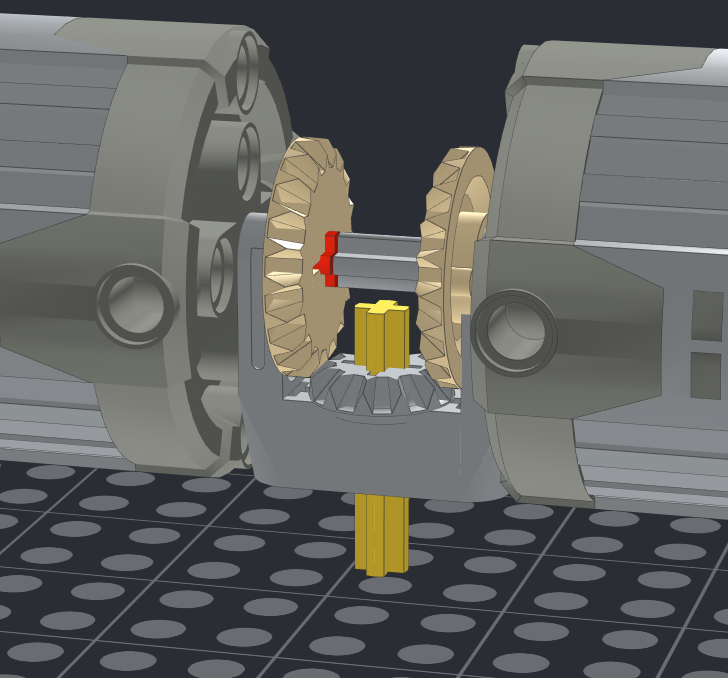

I was going to use something like this with two XL motors above each bogie, 4 XL motors in total (final mounting design is TBD) I'm mostly worried about strength and speed of the overall train. is it strong enough? overkill taking into account the locomotive?

If you do decide to go with XL motors I would suggest bracing the gears with this piece for example:
(https://www.bricklink.com/v2/catalog/catalogitem.page?P=87408#T=C&C=11)
yeah, there is plenty of room in the coach for two battery packs. I figure one battery per 2 motors would be sufficient?  im more worried about the number and strength of the motors themselves. is 4 overkill? would 2 XLs/4 L motors work just as well maybe?
how exactly would i mount this particular piece? im not familiar with this piece.
If I'm looking at this correctly, this set up will not work.  One motor will have to be turn in the opposite direction of the other and they cannot be cross linked.  I've not used PU motors, but a PF motor is powerful enough to damage gears if there is a bind.  Traction is the biggest problem with plastic wheels on plastic track.
Correct. The motors cannot share a pin. There need to be 2 pins that meet in the middle. They can run counter to each other and brush against one another, but they cannot be on the same pin.

they don't share a pin, they have their own independent pin. i am aware how gears work.
