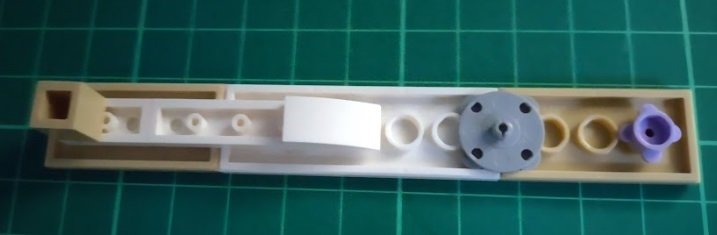

I finally solved a problem I've been having with the wing mechanism in this model.  I always had one pair of S-foils that were loose in either position.  The issue is with the alignment of the worm gears - if you don't have them exactly in the right position initially, the S-foils will always be slightly out of sync.  Looking back at the instructions, there are tiny red highlights at the bottom of the worm gears on steps 7 and 9.  Maybe these are meant to indicate the correct position of the worm gears?
1469031722_Screenshot2022-11-15at12_09_28PM.thumb.jpg.5fc302a0870ba6551036cc86e2a9ac49.jpg
But these pictures suggest that the worm gears should be in exactly the same position.  In my testing, I think one should be turned 180 degrees from the other.  It's finicky because the 12-tooth bevel gears create 12 different positions for the worm gears to be in relative to each other.  But 180 degrees seems very solid, so I think that's the ideal position.
The way to check is at step 37.  If you turn the big gear as far as possible to the closed position, the front and back plates should be locked equally tightly.  If one is loose, you need to pull off the bottom, turn one of the worm gears, and try again.
The thing is, all you need to do is *not* turn the gears until the whole assembly of the core is completed. It doesn't matter how you set up the gears initially, because when you slide in the parts with 8-tooth gears from the front&back, they will accept any position on the worm gears. However, if you turn the gears *after* you slide in 8-tooth gears, the wings will become misaligned.
I think the simpliest solution would be a mention in the instructions that the gears should not be turned until whole assembly is complete.
That's not my experience.  When I start with the worm gears in different positions I get one wing looser than the other, even if I don't turn the gears after.  Also, when you add the central bevel gear it locks the worm gears to each other, so it shouldn't be possible to change their alignment later after adding the 8 tooth gears, right?
The worm gear has no symmetry, so if you give it a quarter or half turn it then the 8 tooth gear will mesh with it at a slightly different angle.  But it's possible that I did something else wrong.  I'd be curious if others have the same issue and which solution works for them.
I did the same as you. Thankfully it's easy enough to pull off a few parts and realign things, but I built and realigned that section perfectly according to the instructions multiple times and it never worked for me. The only time the wings worked was when I offset the gears, unfortunately I can't remember by how much, but your 180 degrees sounds about right.
One thing though: Do you mean the time during opening/closing, or final positions? Because I intended it to work at final positions, but did not worry much if during opening the process was not entirely symmetrical - precisely because worm gears are not.
I wonder if I instinctively put worm gears the same way and this is because it worked for me maybe? Hm.
Anyway thanks for looking deeper into that. I might have been wrong about this whole issue having just one reason and you guys clearly are onto something.
Edited by Jerac
The final position only "locks in" one set of wings, the others need to be helped in position but remain looser. With the correction I (and I assume @20feet too) made the wings are perfectly aligned throughout the opening and closing process, and lock in together.
Speculation time: I believe there is some slight wiggle room for the worm gears in the assembly, this is what allowed me to pry open the second set of wings the rest of the way. Turning the worm gear 180 degrees (assuming that is correct - it has been too long since I adjusted mine) aligns everything so that the wiggle room is the equal on both sides, and therefore eliminated when the wings are fully opened or closed, as they've been pushed up or down in sync. Between those two points the wings feel a lot looser as the worm gears are free to slide up and down on the technic bar again.
Ya, both pairs of wings are loose when in a middle position because of the play in the gears.  They're only tight at the end positions.  But if the worm gears are misaligned, one pair of wings will hit their end position first and the other will still be loose.  @Thwomp and I are on the same page.
